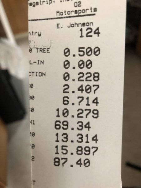

Im a teacher and the Car Club advisor. The kids talked me in to running my car at the track this weekend. First time ever doing this.
First time ever doing this. Car ran great in the quarter with WOT. But did have some lean issues after leaving. Still have some issues to hunt down but pretty happy with how the car is running.. Just wish it was faster...!
