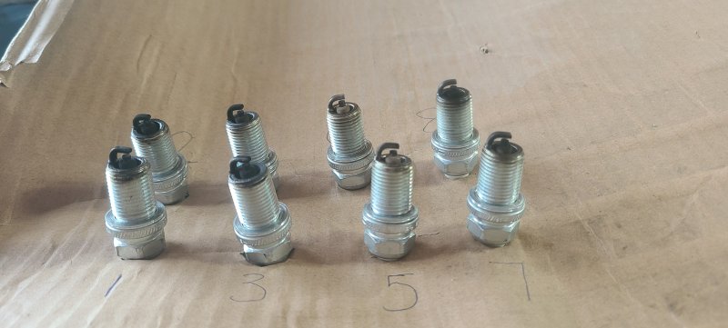

Pulled all plugs most are black with soot number 6 cylinder spark plug broke when i took it out and I noticed its a lot cleaner
#6 plug may have had a cracked insulator before you removed it. That can cause a misfire.
Ok yeah I wondered that. I'm gonna replace the plugs and put on a new ecu and dizzy just to rule that out. Just to verify what side of the carb should i hooked vacuum advanced to. Timed vacuum or manifold?
