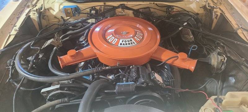

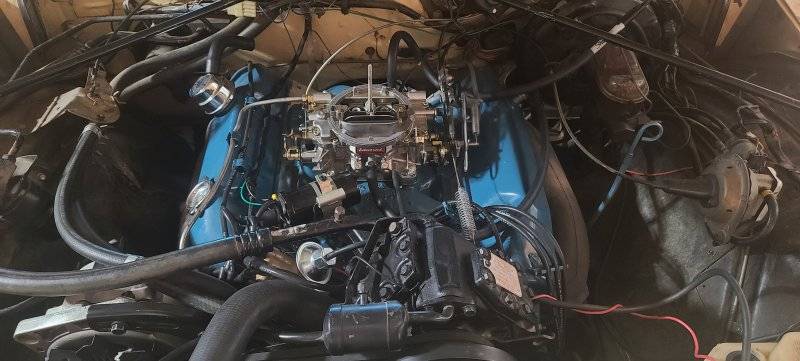

Some details about the car I should have mentioned its been converted to electronic ignition. It has a lunati cam grind VDBCR-258. Keith black 240.040 pistons, been bored .040 over. It has edelbrock 75 cc e street heads and an edelbrock 1407 carb with manual choke.
