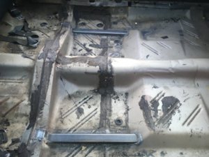

I made mine from 2x3 tubing and simply welded it through the floor on my '64 Polara. Cost...$20 for the steel. They effectively created a full frame car. Huge difference in stiffness of the chassis.

Hey bearman, I did find one photo from inside the car. It was hard to cut these nice floors but worth it in the end! I'll take some from underneath after the rain.

Thanks i know what your saying about cutting nice floors mine are great. But some of these have to replace because of the rusty mouses and i feel for them
I also have to do the welding upside down because mines not on a rotisserie.
