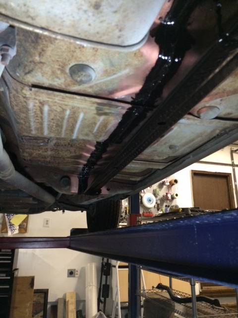

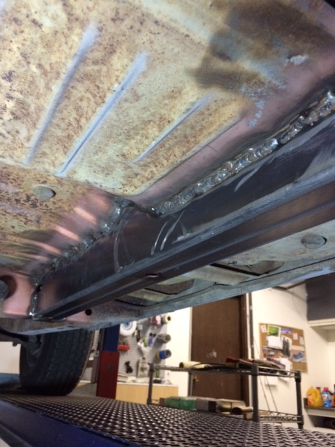

View attachment 267785An update for anyone interested in my progress. Got the sub frame connectors welded in and did the POR 15 treatment. I followed the instructions to the letter and it came out as predicted. I will do the rest of the underside but at a later date, just wanted to give this aspect a try and protect the raw metal from the onset while doing a trial run for this product. Thanks for the help with installation of the sub frame connectors and ALL the advice with DO's and DON'TS of the POR15.View attachment 267786

Got lost trying to add to my last post...oops, haven't figured out all the aspects of doing these replies. Anyway, I cut the pads for buckets seats and welded them in while I was at it. Mine has a bench now but I may want to add buckets later. Welded those pads in before I did the POR15 on complete underside to keep from burning that off. Mocajava
Wasn't it fun welding on the connectors on the rocker sides compared to the trans side? Not much room up there to get the welding head in plus contorting yourself to try and see where you are during the process.
Absolutely! Thought several times about just skip welding the outer seams and leaving it at that. I perservered and finished the job the right way though, welded from one end to the other....stubborn I guess. Asthetics mean a lot to me and I know i would have kicked myself the first time someone saw it incomplete and made a comment. Will be doing the entire underside with POR15 after I get engine, tranny and rear end stripped out of her. That will be a winter project for me.
