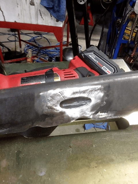

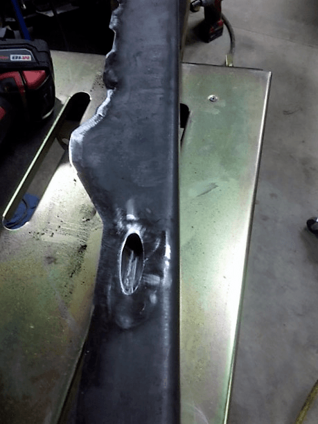

U.S. Car Tool says to cut holes to allow the brake cable to pass through if you are still using them, what I did was to mock it up and mark where the cable needed to be and cut holes on the diagonal and weld in a piece of tubing so that the frame connector doesn't lose any strength.
