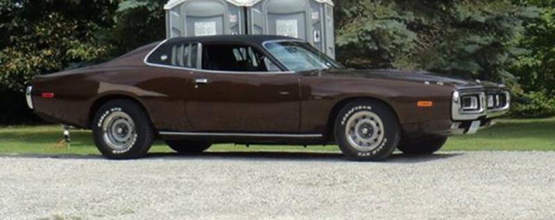

I did mine on my 74. I slotted the fronts 1185320_10151573217279499_2001218289_n.jpgand used the 71-72 rears. one thing to look out for is the fit of the front grills around the headlights if you are using the 73-74 grills as you are moving the grills back with the bumper. I used 71 grills on mine.
