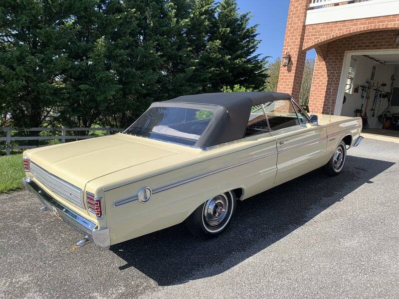

Thanks, Lefty71! Currently, the skirts are off the car. I found a set of spinner hubcaps off a 66 Satellite, and the skirts mostly cover the spinners. Here is what she looks like now.
