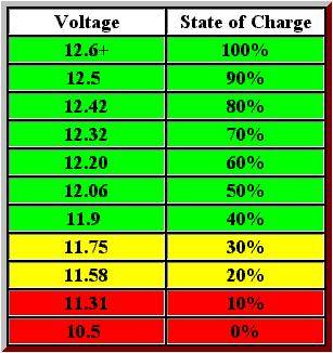

11.8v at the battery isn't good. It's either a dead battery or there's a problem with the charging circuit or voltage regulator.
