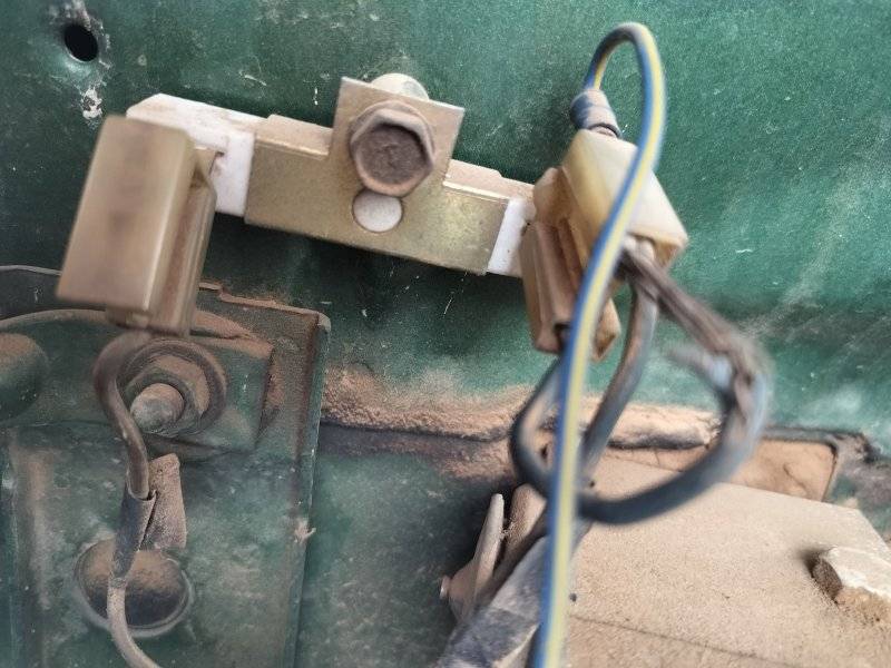

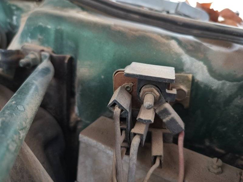

Snap us some pictures of your ECU Ignition Module and your Ballast Resistor installed the way you have it now
I can tell you if it’s a real transistor / fake heat sink and I want to see your ballast
Thanx

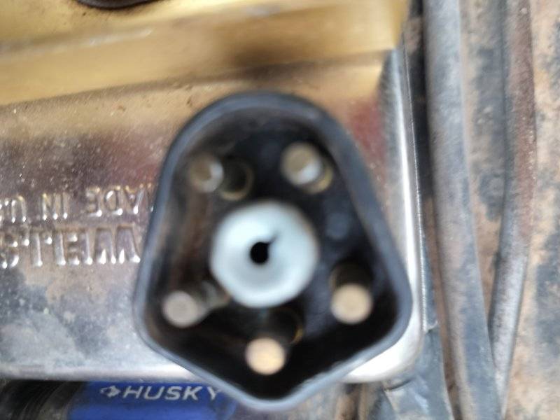

5 pin, single terminal ballast
Is what you said
confirm indeed five pins , not four
Yes it's a five pins. Five wires.
It's set up like the Mopar performance conversion.
Just because five wires , doesn’t mean your ignition module is five pins
All those plugs where five wires

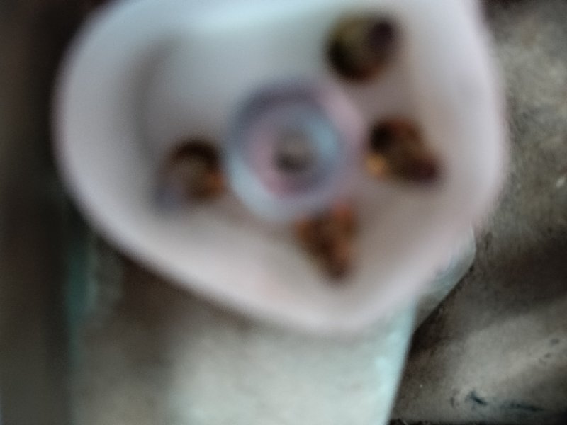

You won’t know until you pull the plug off the ignition module itself
Honestly you don’t see many factory five pin ignition modules anymore , but that’s what you stated five pins , not four
During my testing I took the connection off. 5 pins.
Do I need five pins? I don't know. I didn't set up this conversion.

He is running a FIVE pin ignition module with a SINGLE ballast resistor
You need 4 PINS Ignition Module if your running a SINGLE ballast resistor

Looking at your pic's, much shoe maker-ing by the previous owner....giving rise to the fact that some people should NOT BE ALLOWED to open the hood....maybe just to check the oil.....to be relegated to washing and waxing the car....period........just my opinion.......

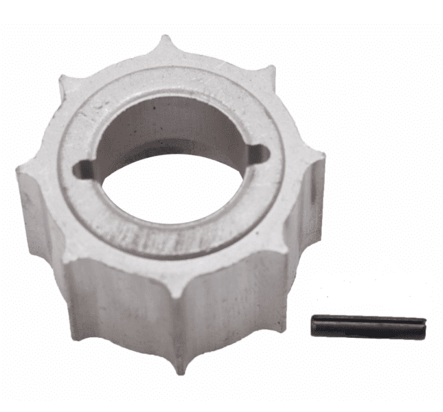

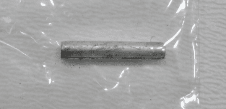

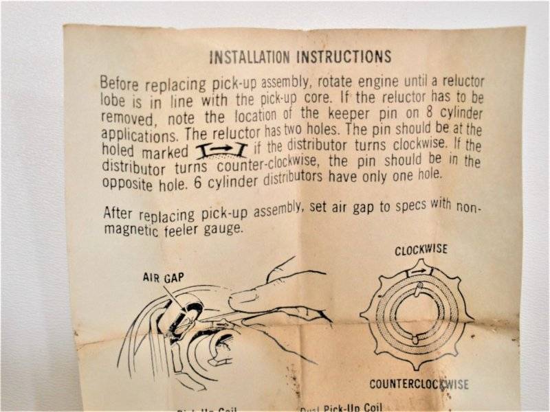

Well........sooooo um I was able to get some spark, but I pretty sure the distributor reluctor / rotor should not be able to spin freely.
If it is spinning on the shaft, it sounds like it is missing the keeper pin, or the pin might have sheared off or worked its way out of the groove.
