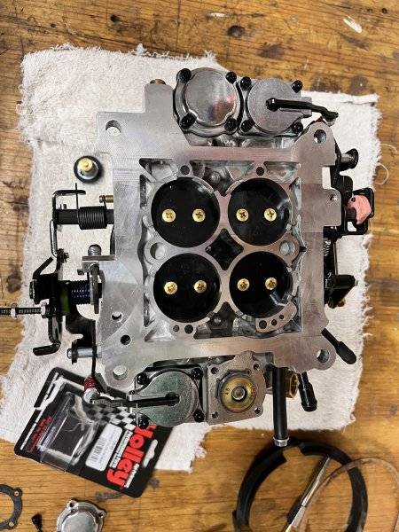

Hey guys. After converting my 65 Satty to a 4spd I wanted to go with a 750 double pumper and swap out the 750 vac secondary that I had. I ended up getting this summit racing 750. Was told it was a rebranded Holley 4011 from back in the day. Well after swapping out power valves and jetting to my cars needs, I got her running like a champ but overnight the primary float drains out and I have to prime it to start the car. When it fires up (cause it acts like it’s flooded) it blows massive black smoke out the exhaust. The idle mixture screws don’t make a diff and I can even turn them in all the way and the car still runs. Thought maybe it was a bad PV so put another new one in with same results. Now I know for a fact that my transfer slot is showing a little more than square because i have to turn the idle set screw up a little to get the car to idle. Could the transfer slots cause the fuel bowl to drain? Not sure what to check from here. Always had Eddys on my cars but from recommendations I wanted to run a Holley. 3C344011-CADA-4D90-9BB9-60BA87B404C5.jpegA6F736E4-D6C8-4341-989F-03012098F1AB.jpeg480BA080-DE23-4106-978D-A789A13EF902.jpeg63B3CDF2-7731-46C8-ADD5-B6F4D6FD1C01.jpeg

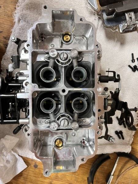

Fill the bowls with gas and see were it leaking from.
Put something under the outer edges to hold it up high enough to see the bottom.
Thats the thing is there is no visible signs externally but the car acts as if its flooded when I start it and it smokes really bad. Not to mention, the oil now smells of fuel and needs to be changed. If I take the carb off and let it sit on the bench overnight, it won't leak a drop and the level in the glass sight is exactly the same. If I put it on the car and run it for even 5 minutes and let it sit, the level drops. I can see the fuel halfway through the sight glass and within 3 hours you cant see any fuel (primary only - secondary doesn't budge). If I then remove the top of the carb and look into the bowl, its bone dry
Maybe try adding some ATF in the bowl vent when you stop the engine.
The dye may help you find it. The casting may be porous.

When you run it and then shut it off, with the air cleaner off observe from the top for awhile, do you see gas trickling out of the venturis?
This could help tell if you've got pressure in the bowls that's escaping, a plugged vent, etc vs a cracked casting
