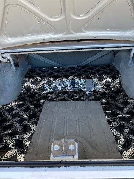

Got projects going on in the engine bay and the trunk..... bringing some civilization to the beast..... Dynamat in the trunk of course I did not order enough..... FedEx and UPS trucks fighting to get up the driveway..... :thumbsup:
