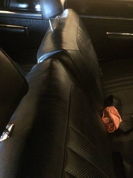

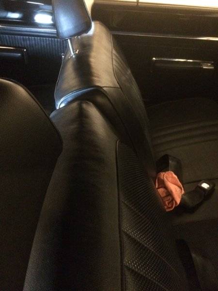

Here's a picture of my 69 Bee's front bench seat. As can be seen, the passenger seat is leaning back farther and is kind of annoying for the wife. Is there anyway to adjust this, or something I should be looking at? Might the seat release be tweaked/worn out and allowing this? Both seats used to be at the same tilt, but then I let an oversized buddy of mine sit in the car and the seat's never been the same since. Does anyone sell the seat release separately?

I wish I knew what else to look at, but the damn seat is so simple, not much to mess with so I'm at wits end trying to figure out what's wrong.
I think your last comment kinda speaks for itself, as to what happened.
Yea. :( I'm wondering if the "catch bar" in the seat bottom that the seat release locks on to got tweaked? Need to go measure and see........
well the passenger "catch bar" is lower than the driver side. but only by an 1/8 of an inch or slightly more.

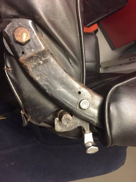

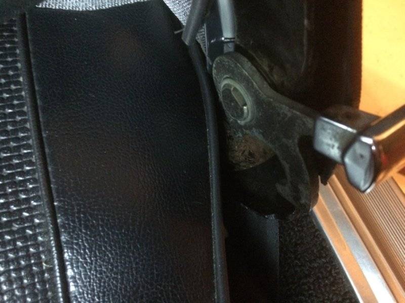

See the picture of my Bucket seat, think the mechanism will be the same.
The frame of the back seat rests against the pin, the same pin where the latch catches on.
The latch will not be the problem, the latch only holds when the back rest is pushed forward.
That pin will be bend due to an oversized occupant, if i am correct this pin is threaded in the end and bolted in the seat frame.
Could try and straighten it up.
you can smack it with a hammer, but be careful, as it could break off and then you'd be in worse shape.
It might be welded on also. If you do straighten it and it comes off you will have to weld it again.
Oh I know, I got the big pry out and tried prying it up, and thought, "oh crap, if I break this, I'm really screwed then!" But hard to believe the big guy could bend it, yet I can't with a pry bar.

On the bracket mounting the seat to the floor is there an adjustment? Looks like tilted M maybe it loosen and leaned passenger side back, worth a look.
