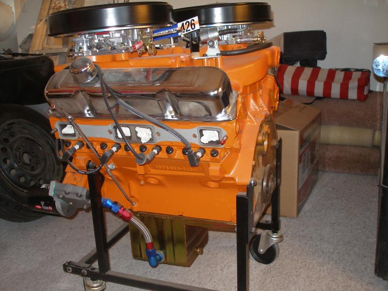

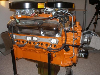

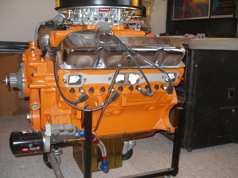

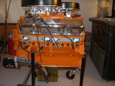

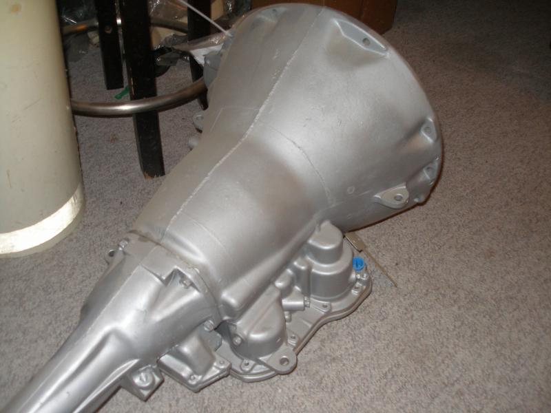

This is going in the 1963 Polara
A "440" based MAX WEDGE style

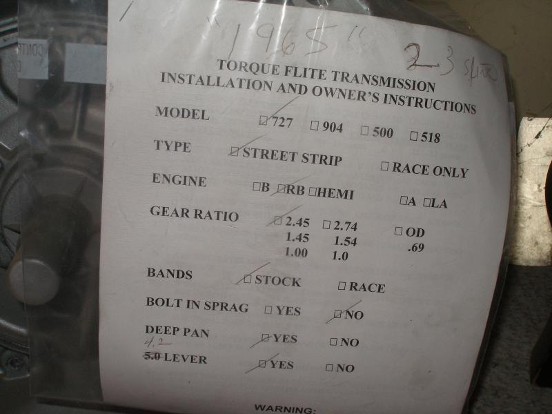

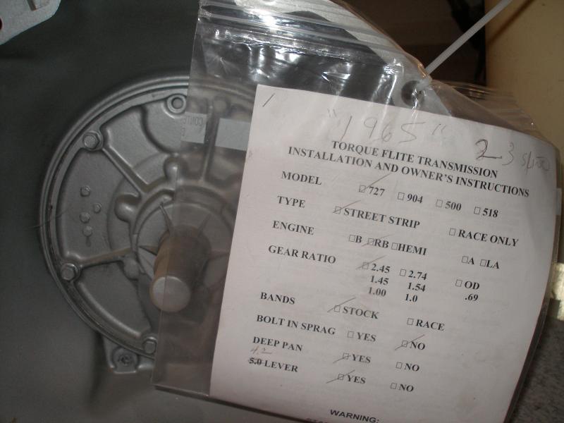

Also, the 727 "Built" with Spec sheet.....

Is that pan gonna scrape the ground? That thing looks huge!!!

Yes, it's a pushbutton...
A good friend of mine in riverside CA (Bob Mazolinni of "Bob Mazolinni Racing") had a 1965 trans for me...he had his "bud" re-build it. There is something about the hard to find 1965 Trans for the pushbutton set-up...
5.7: It's a proven set-up from Dale Reed...
He says its ok...
HP? I'm not sure ma mopar nutz....
I didnt Dyno it but Dale Reed ran it on his break-in set-up..
He thinks it's an easy 550HP
The Rods are the real good H-beams with a great steel crank....
The best of everything in the engine...
I got the engine from the guy I bought the Superbee from...
In 1995 he wanted 500 HP, he threw away the Bee's original 383 so I went to the junk yard and retreived it...from salvage..
He spent $8K on the engine and $2K on the heads...
He left it at my house for 11 years, never returned so i turned it into a Maxie style engine..
I brought it to Dale Reed in Baldwin Park CA (He builds ALL of Bob Mosher's engines)
I had Dale re-do it...he says it's a great engine...
