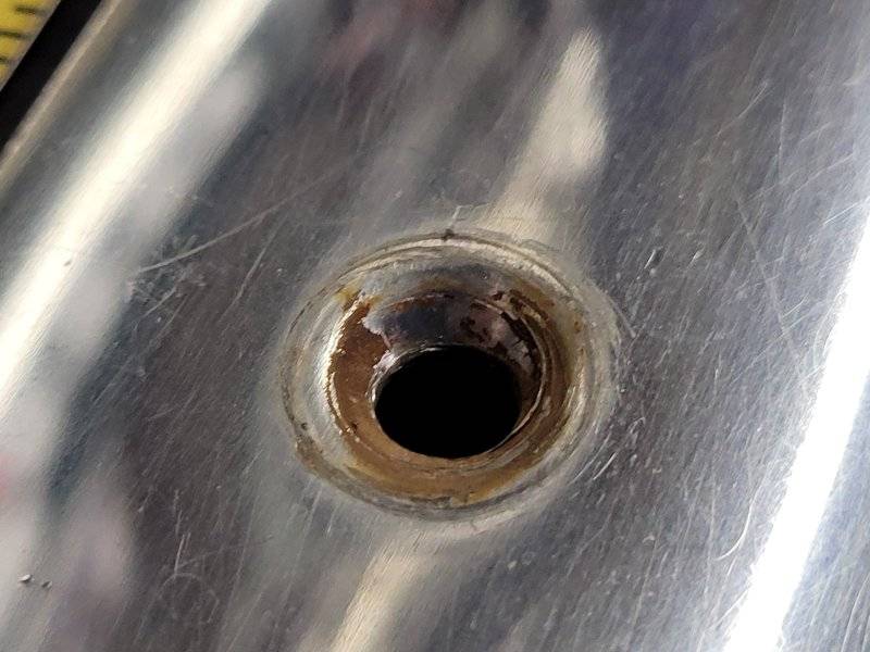

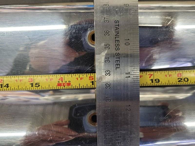

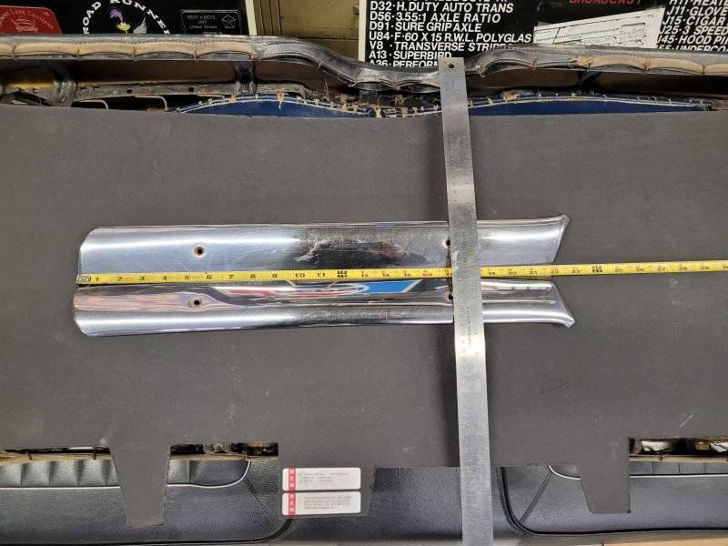

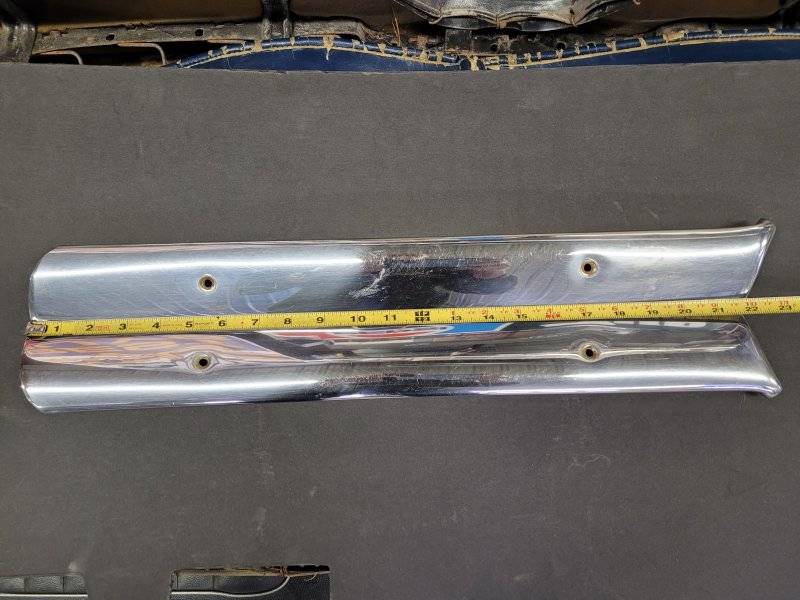

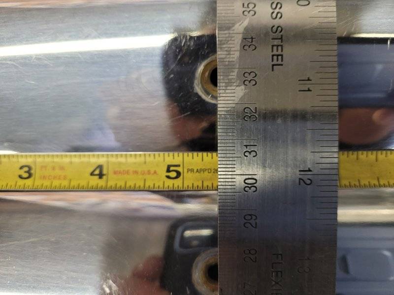

I took mine off before loading my car for the body/paint shop. Give me a bit...
dadsbee
11:42 PM
Jan 29, 2018
15,821
45,862
Midland Ontario, Canada
From the bottom end. 5 7/16 and 17". I won't comment on the Phillips screws as I've never confirmed mine are correct. Yes the holes are dimpled for oval head screws.
