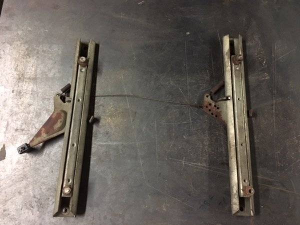

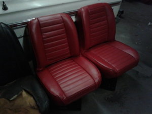

I've had an old set of A-100 seats out of a D300 truck. Recently I decided to put them into the '64 Fury Convertible I'm building for my son. The old bench seat is broken on the inside. I used brackets that a fabricator from my area made for me. They offset the seat to the driver's side too much, so I'll be making new ones to center the seat up.
The seats came with adjusters. I am not using them. If anyone is interested, I'll let them go for $50 and the ride. PM me if you are interested.

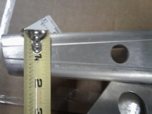

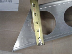

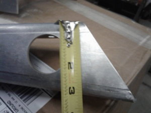

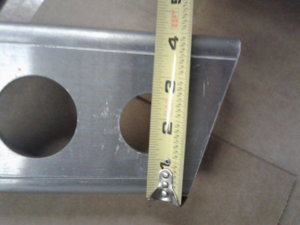

Here is some rough measurements of Gary Ball's brackets.

Kinda funny, Just got my seats in the mail today !
