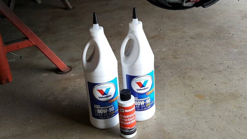

Been using this one for years. Also add a tube of equa torque friction modifier for the sure grip clutches or cones.

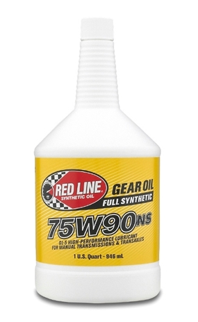

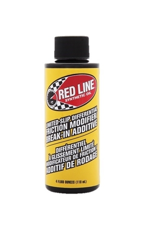

I use Red Line 75W90NS GL-5 gear oil and Red Line Limited Slip Friction Modifier for tuning slippage...
For maximum lock up add 1oz of Red Line Limited Slip Friction Modifier at a time to clutch-type limited slip units to eliminate chatter.

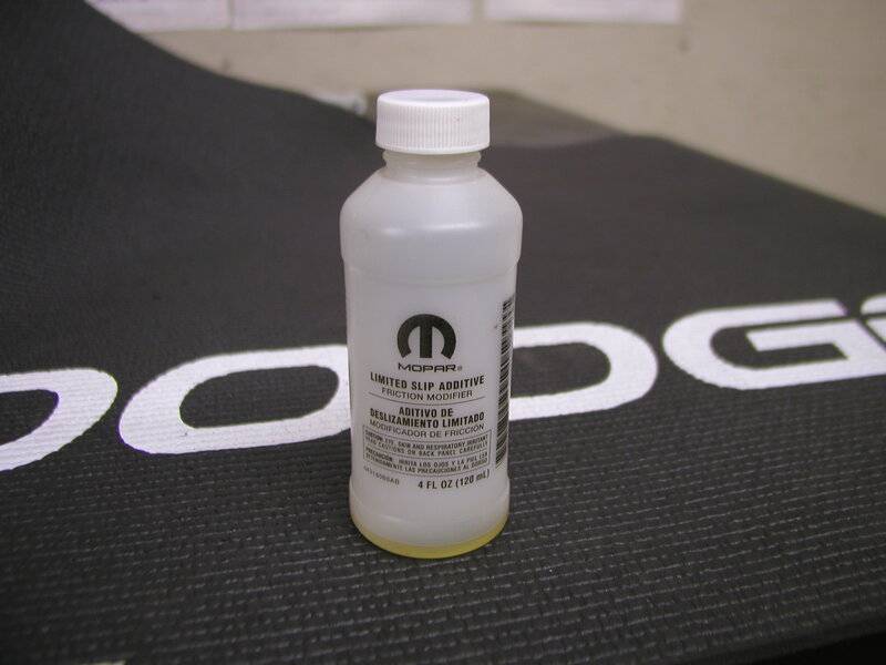

I have Mopar additive in my sure-grip. It sure did make noise without it one time when I changed the fluid and forgot to add any.
For sure the clutch type limited slip needs the additive, Ford gets high praise, Mopar worked fine for me in the mid 70's & 80's with both 8 3/4 and Dana so did the Ford. The lube style that claims to be good for "posi" doesn't work adequately. Any of the quality gear lubes Valvoline, Lucas, Red Line, Mobile 1 with the Mopar or Ford friction modifier.
Mopar limited slip came in two forms, the early "clutch" style and later "cone" style. Both should use the friction modifier.
