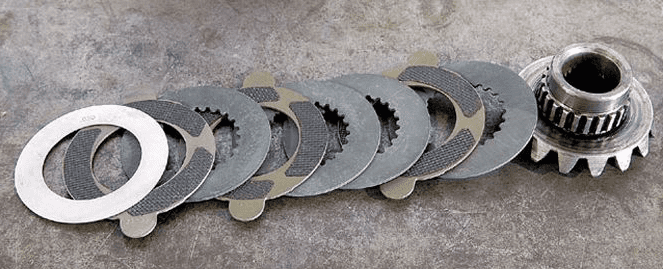

This is for a Ford diff but some suppliers did similar for the 8.75 in the past...
On a basic level the cones have a “fixed” breakaway torque. Always the same but decreases as they wear. The clutch types have a base breakaway torque but as torque is applied from the driveshaft that increases. Worn clutch types still lock up under high torque because of this. Worn cones become “one wheel peel” sooner.
Looks like a TracLoc set up? My 2000 Durango had one and at 25k miles it stated chattering really bad so I drained the fluid. In the bottom of the case was this load of goop and I'm thinking it was clutch material. The car wasn't raced or abused unless you consider my wife at the time jack rabbit starts and wait until the last second to stop abuse. In went the new fluid and additive and in less than 5k miles it was acting up again. Another fluid change but this time a bottle of STP went in and it remained quiet all the way up until my now divorced wife burned up the engine. It had just over 100k miles when she left.
The Sure Grip in my Dana 70 chattered with Syn lube which was supposed to have the additive in it so I added a bottle of STP but it didn't help so it all got drained and regular lube went back in with 2 bottles of the Mopar additive and it's better. I can still feel a little bit of chatter but I've only driven it a few miles.
