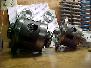

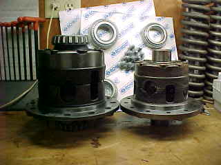

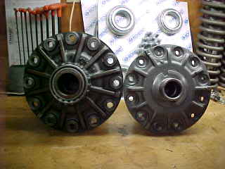

Cone type not represented here and have posted this awhile back but time for a refresher? Torn down several 8 3/4 Powr-loks (Power Locks?) that had messed up spiders but have never torn down any PL's from a 60 that had broken spiders and may be this is why.....?

Great refresher cranky......Proof is in the pudding.......

Does anyone notice the reliefs for the bearing puller on the 8 3/4 clutch unit? The cone units do not have that and is proof positive that the cone units were never meant to be rebuilt.....
I have a newer Powr-loc that came out of a late model pickup (has a tone ring) that doesn't have the reliefs either but the shoulder is smaller in diameter and looks like you can at least use a clam shell on it.

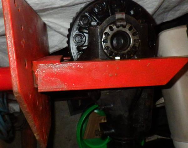

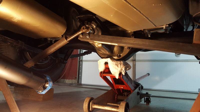

Here I am and my setup today, getting the nut off my 742 so I can change the seal. Attached a angle iron to the yoke and had a pipe sticking out the side of the car to stand on. I think I hurt myself!
You can lock the center in a vise, use a big adjustable (or the tool you've already made !)wrench to hold the yoke while you loosen or torque the nut ..... OR .... you can make a jig out of steel tubing (1/2" maybe) to bolt to the center section to keep it steady while you work on it ...
