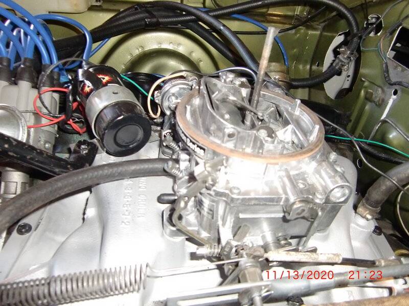

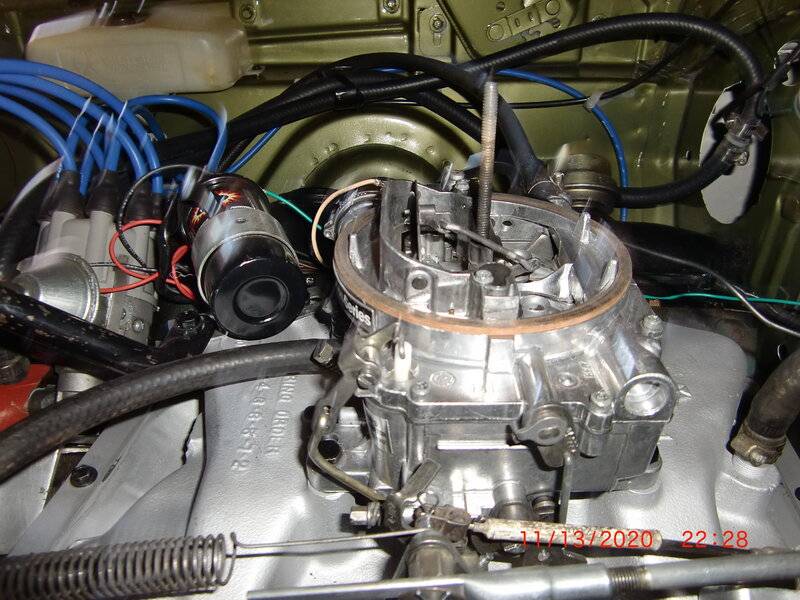

Went into garage this morning and pushed the throttle once to set the plate. looks good to me. Started engine and same condition as the 2 other previous mornings. But you guys got me thinking it's a tune problem and that got me back to the cam,lifters,chain,springs replacement this spring. All is well with that, however, since the new cam was quite a bit more aggressive I had to set initial timing to 20* btdc and tune from there. I'm running with the vac disconnected from carb, and for 4 months the engine ran great until the cold spell hit. I live in AZ. and the tune was set when it was probably 110*+. I brought the timing to 10* and tuned for best vac & idle. Will have to wait until next morning to see if anything changed. Will fill you in on progress then and thanks for keeping me in the ball park with it being a tune problem.
There is more to how a properly adjusted choke works than just the choke plate closing.
You're right about the choke! When I rebuilt carb about a month ago, I set up the fast idle to the top detent and than adjusted choke spring pressure to get plate located. What I didn't recheck was when I reset the throttle was the fast idle position. I was only watching the choke plate position and what I realize now is that the fast idle cam is only returning to mid position. Tried adjusting spring to its fullest adjustment but no dice. Hunting down new choke, looks like it might be a day or two. Carb is carter, maybe edelbrocks will substitute. I guess when the cold snap hit last week the fast idle position became critical, while before it was close enough to get it started. Thanks again. If I didn't mention before, this is an electric choke. The original choke set-up was long gone when I got the car.
