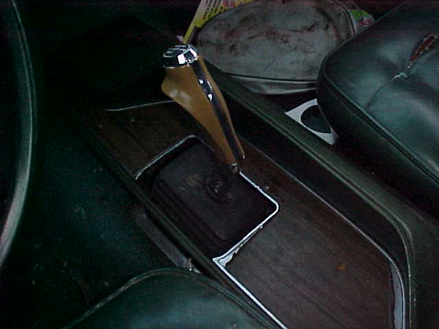

The 71 satellite I just bought has a 727 auto (383 engine)..buckets and center console. If I want to swap a 4spd, can I use the center console, or was a diff't one made for 4 spd cars?
The console was different.The 4 speed had a cutout at the bottom to accomodate the shifter and obviously the lid was different because the shifter hole was bigger.
Alot of people that switch from auto to standard dont use the console

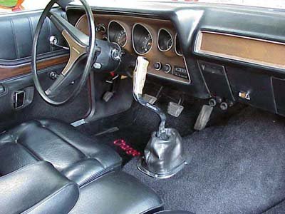

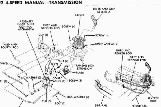

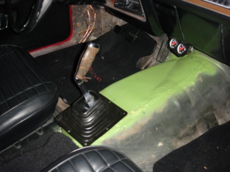

bench or bucket 4 spd-

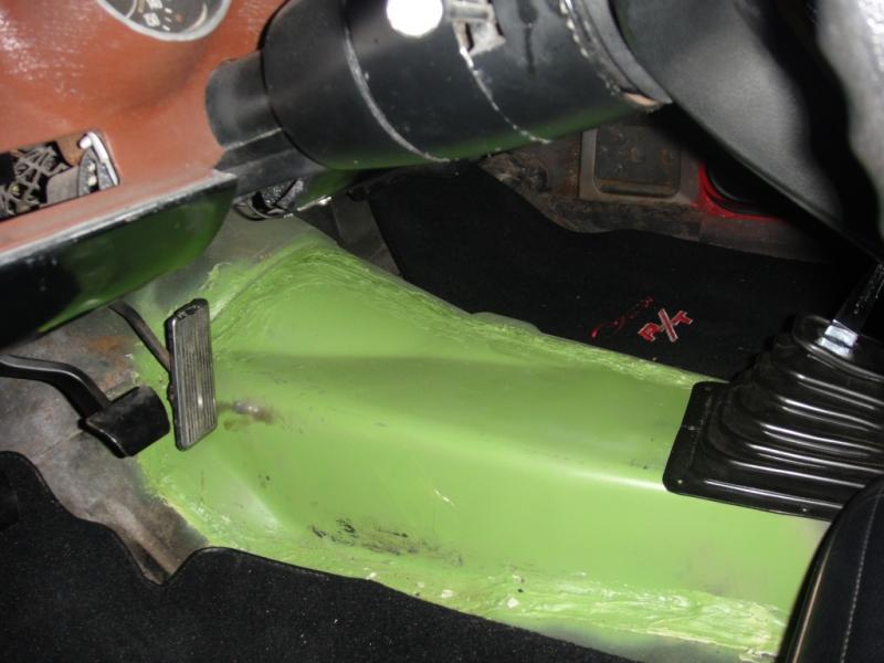

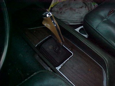

Just finishing up a conversion to 5 speed from a 727 on my 71 Charger. The console and top plate are different for Auto vs 4 speed.
The carpet is different as well - Auto, 4 spd Bench, or 4spd bucket seat carpets are all different.

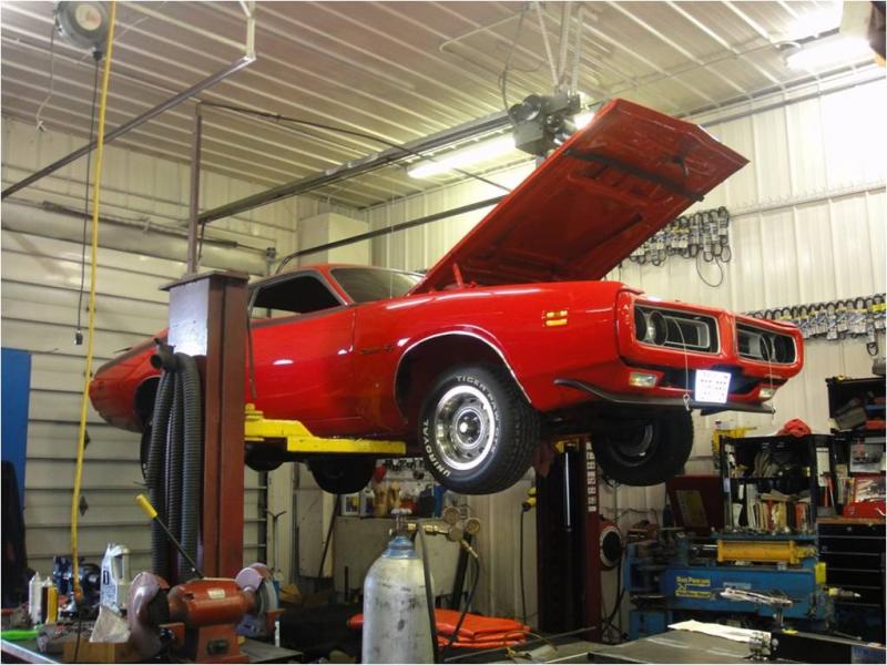

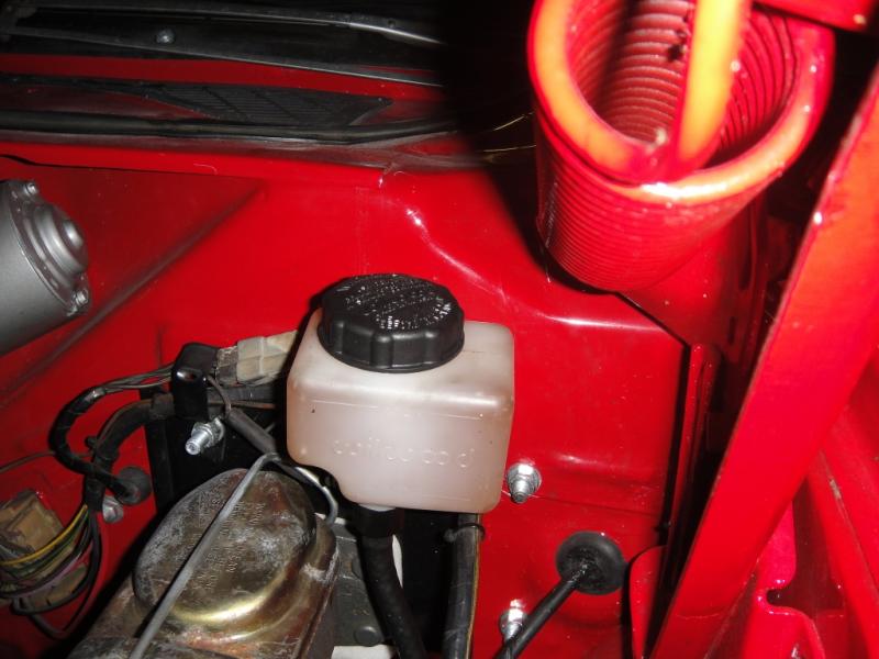

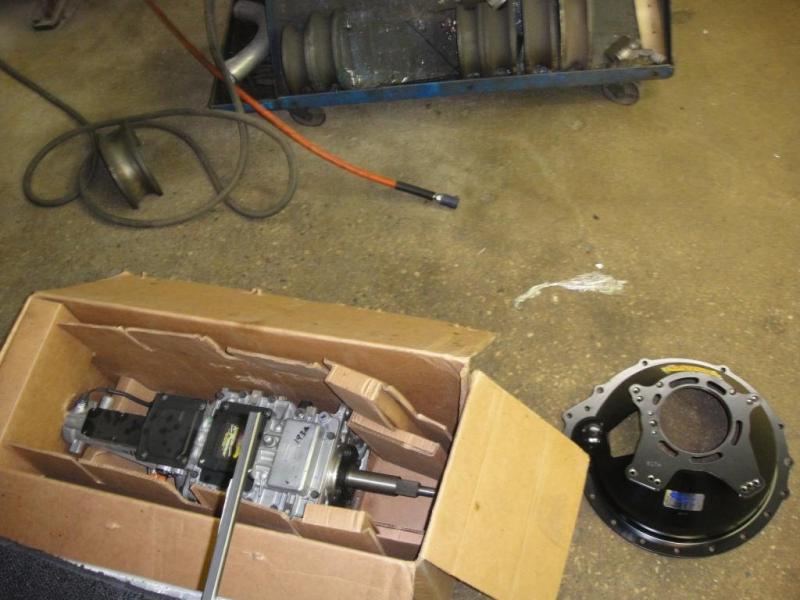

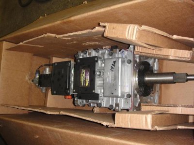

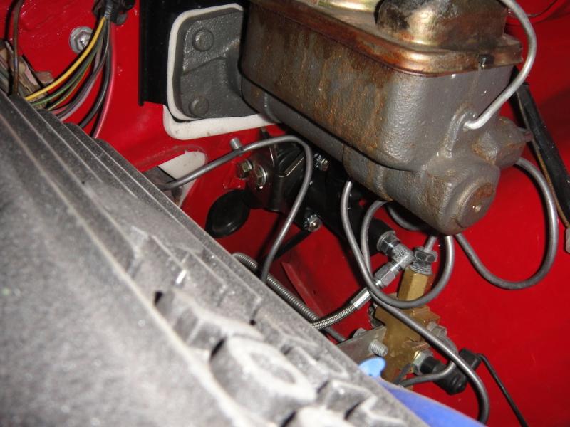

Hey Wookie316,

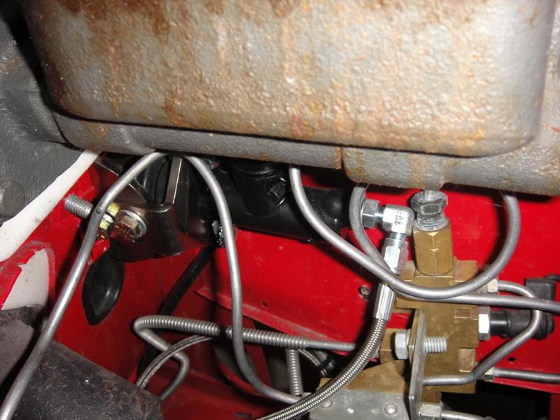

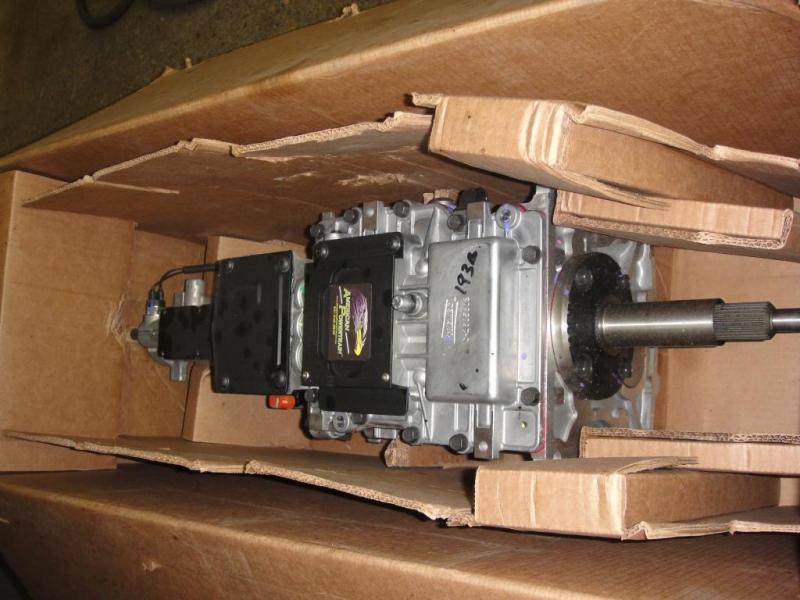

Went with the TKO 600, Science Friction Stage 2 Street Slayer Clutch, and hydraulic clutch throwout . Bought the complete package from American Powertrain. Not overly pleased with the company. I was told they had all the parts, took my car to a shop to have them install it, sent in my money and then they told me the hyd throwout bearing was on back order. Bunch of crap. Took about 4 weeks to get the part. Then after installation I get the car home and the throwout started leaking. Bad seal from the factory. Took it back to the shop and American Powertrain said the part was not available for 2 months! Then they said they would send a new seal to be installed in the bearing. It leaked also. Finally after some serious bitching at America Powertrain they "found" a new throwout bear which didn't leak.
On the other hand, the shop I had install the set up did a great job! Not only that, they did not charge me for all the extra rework because of the throwout problem.
I give them a A+++++ and would recommend them to anyone:
Kilpatrick Racing in Waukesha, Wi. Jim has forgotten more about Mopars than most people know. Jim is a top notch guy to deal with.
Anyway, after all the drama, I am really please with the set up. Finally have a big block Mopar with a stick shift that I have always wanted.

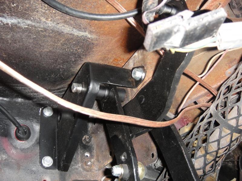

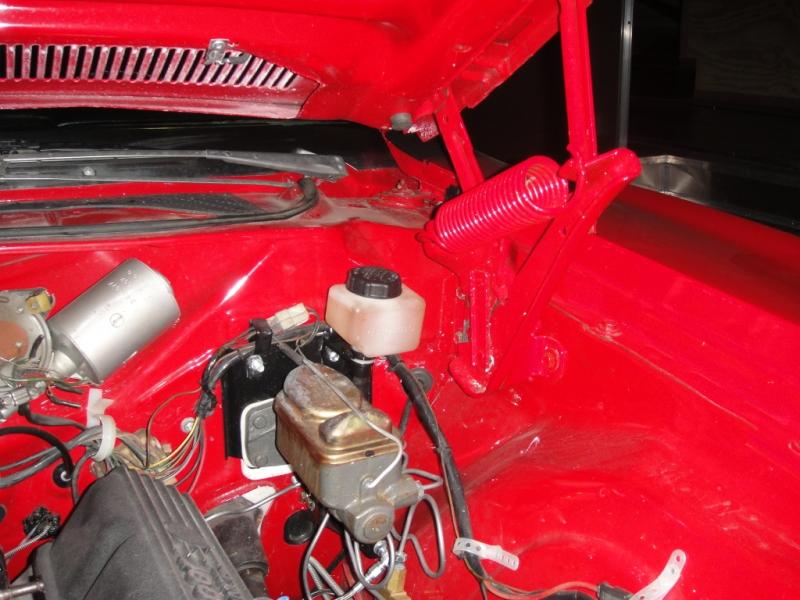

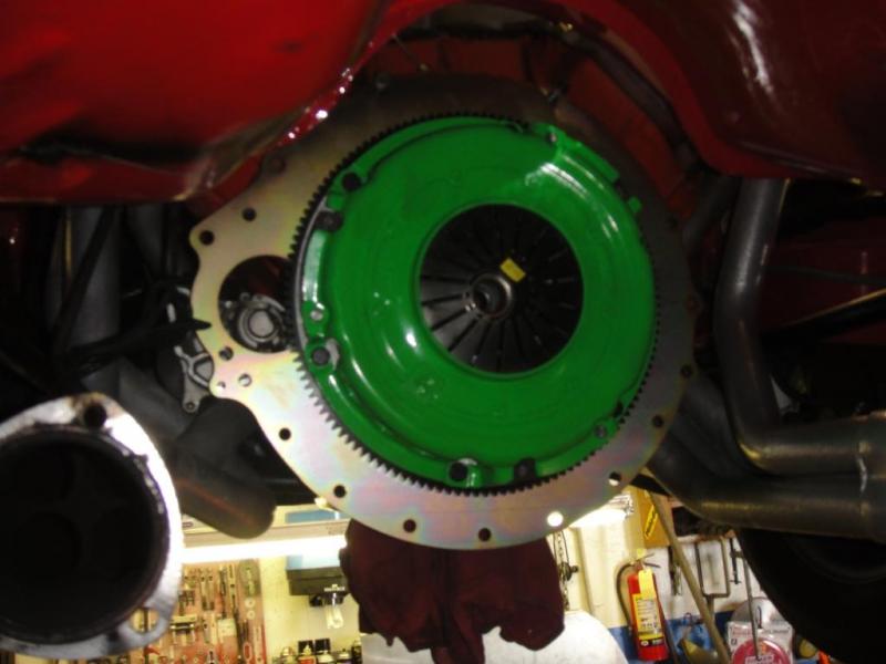

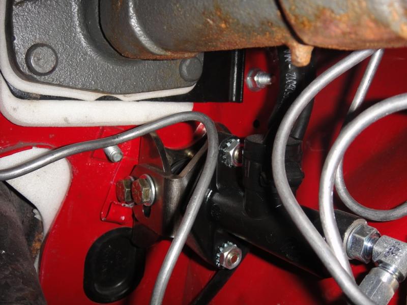

Ma Snart
I have my car at a shop right now & they will be putting a TKO 600 as welli didn't go with a hydraulic clutch though. Hopefully it is all there when they go to put it in. If you have any more picture you could forward me, I'd appreciate it. Send me a PM & ll give you my Email address. Thanks.

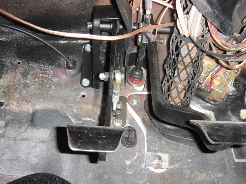

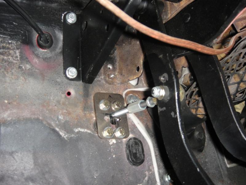

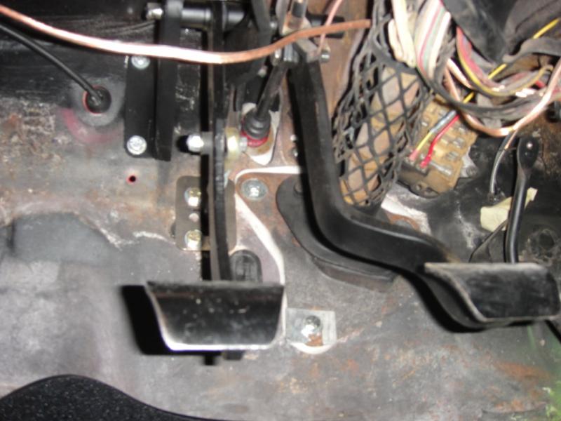

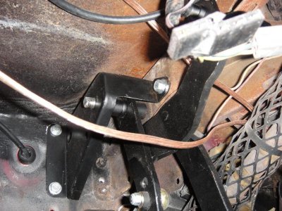

Here's some pictures. Couldn't get under my car to get underneath pictures the way I have it stored.
Hope this helps
Ma Snart
