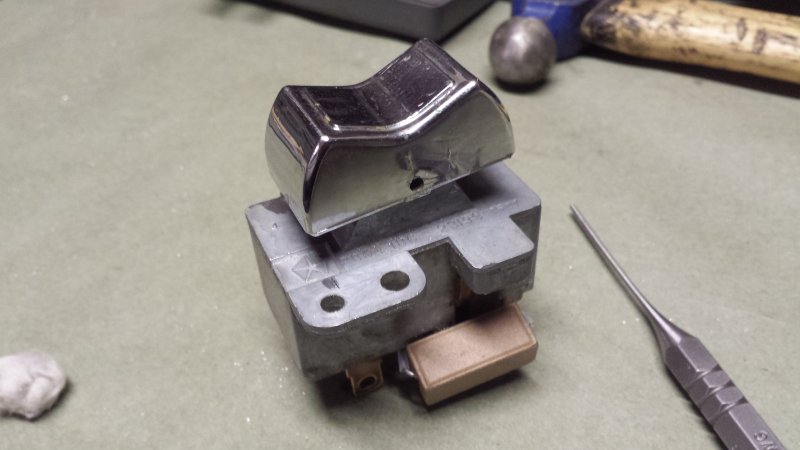

Well I started sorting through the parts I have
And no place do I have a 3 speed switch laying around
I have two of the 2 speed switches
This is the picture of it in my dash
Yes I know the picture is upside down but so is the dash sitting on the shelf at the moment when I had to lean over to get the photo

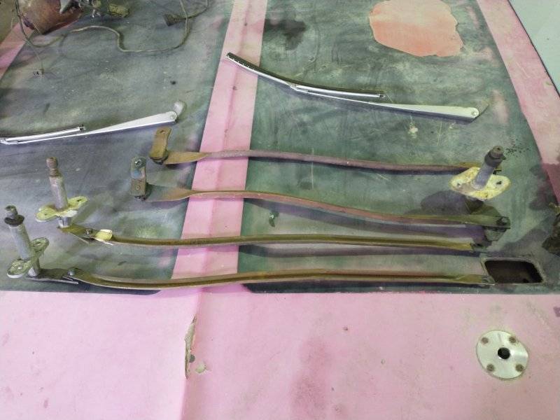

These are the parts that came with my car
The linkages have the motor crank on them but think they are the 2 speed version
And I'm sure you're wrong! I swapped over to 3-speed wipers. Got the correct b-body switch with a crappy rocker. Removed my perfect 2-speed rocker and it absolutely does not fit. When I'm in the shop later I'll snap a shot of both switces and show you why. If you're going to modify things then, yeah, maybe they fit. Maybe you could modify a switch from a Russian Trabant, who knows, but that wasn't the point !!
Show me picks of your switches.
These are two working 3 (left) and 2 (right) speed switches. Same rocker for both. So I am 100% correct.

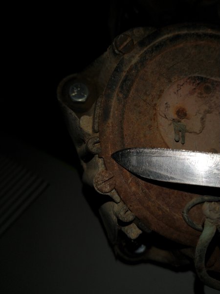

So I started digging through my spare parts pile and have a few of the 3 speed motors to choose from
All of them have the crank still on them
The two sitting on the left seem to be the proper ones to use so think they have the right wire harness with them
The last picture is one I stole from a Natcho post and it shows the little tab and what notch it sits in to clock the wiper motor to the proper rest location ( is how I decided which 2 were B body parts )
The housing are not an exact match to the Notcho picture but the wires seem to make sense on the two I saved out of the group and both have the notch pin in the same spot All the others in my group were in a different place
With the parts I have I have enough of the clips to make all the lever arms fit but it seems the wires on my motor are in sad shape so will have to send it out to get fixed up
