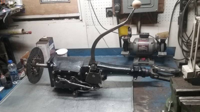

Going to install a 4 speed in my 65 satelitte
Tired of the leaking automatic.
I rebuilt the transmission collecting parts for the 4 speed change over.
I understand there may be issues with pilot bearing bore depth. I don't like the idea of cutting the end of the input shaft so I'm wondering if anyone has drilled the hole deeper in the crankshaft and whay was the method for doing this.

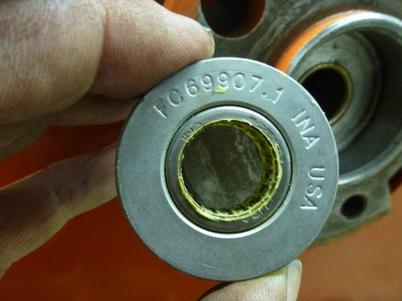

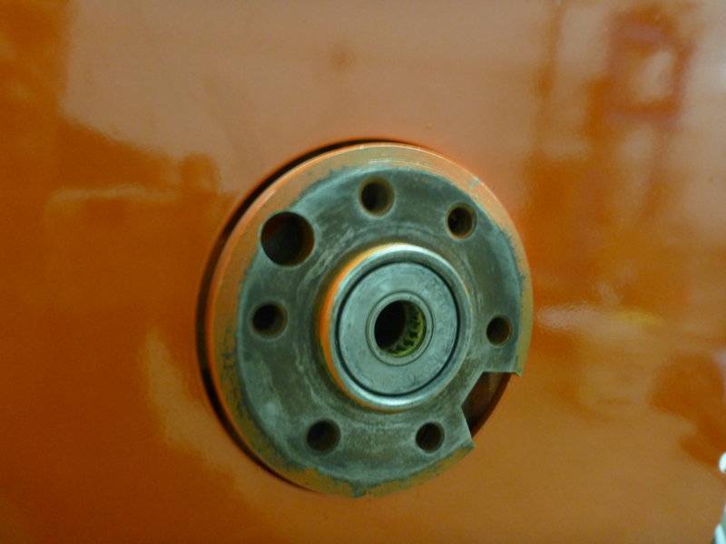

Well ideally, you'd want the crank out of the engine so you could machine it as the hole needs to be dead nuts center so the bushing rides centered. I wouldn't stress too much on shortening the input shaft. It is it's own piece and can be replaced fairly cheap if you ever wanna go back. The Dodge Dakota uses a roller bearing for the input shaft that I have heard alot about. It's probably the best route to go as you'll never get that hole true to your input shaft with a drill and using a bushing. I believe the bearing installs in the ID before the furthest hole in the crank and would be a way better option for your case. Just as stated above, it would keep your input shaft true without having to worry about the hole being exactly centered and shortening the input shaft.

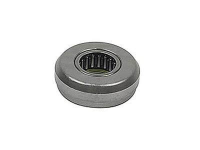

Ok so looks like my best option is installing the pilot bearing from a dodge dakota second time I've heard this. Thanks for the information.
https://www.moparonlineperformance.com/product-p/p4876056aa.htm
It installs flush with the end of the crankshaft, one side has a chamfer on it to help it get started. Like @91r/t said, just cut the input shaft, redo a chamfer on it and install. As he mentioned it’s a separate piece and not all that expensive to replace if you ever wanted or had to, but if you use a bearing on whatever motor you use you’ll never need too.
Note, there are two different mopar performance part numbers for the same bearing. One is 3 times the cost of the other. That’s the only difference.
