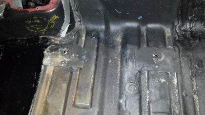

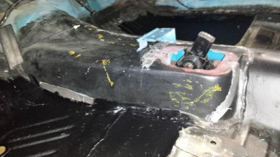

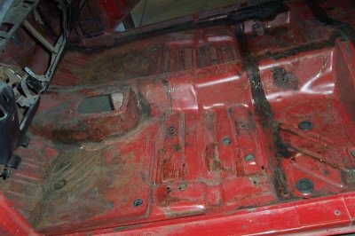

Here is the bucket hump and the bench hump.
Also buckets had supports plate on top of the floor. E-body has them on the bottom side of the pan.
