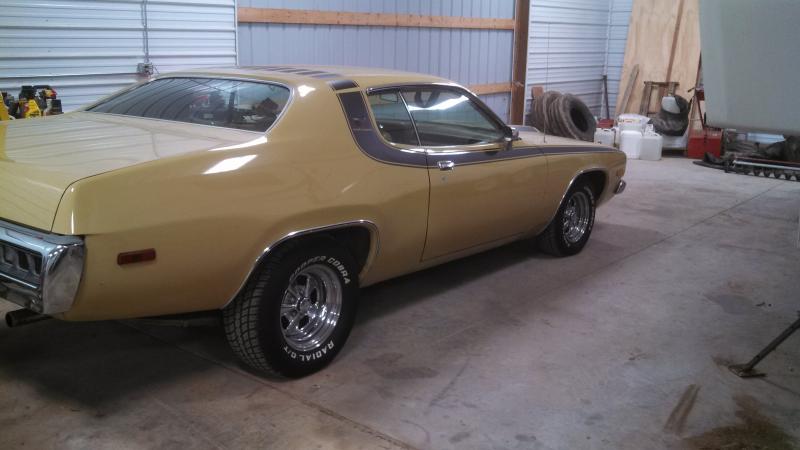

I found a 8 3/4 housing at Indy swap meet and it's about 1 1/2" too long. The perches are dead on for my Satellite at 47". Do you think I can get by with a little longer or should I have it narrowed? I don't think tire clearance will be a problem. Probably get work done at Mosers since I'm only an hour away from them.

That's only an extra .75" on each side... I would try to not have it shortened and save money. Just make sure your current wheel/tire setup has enough clearance on each side. A lot of guys put wider than stock rims on these cars anyway. Just my thinking.
This is what is on it right now as far as wheels go
