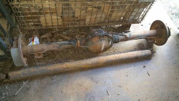

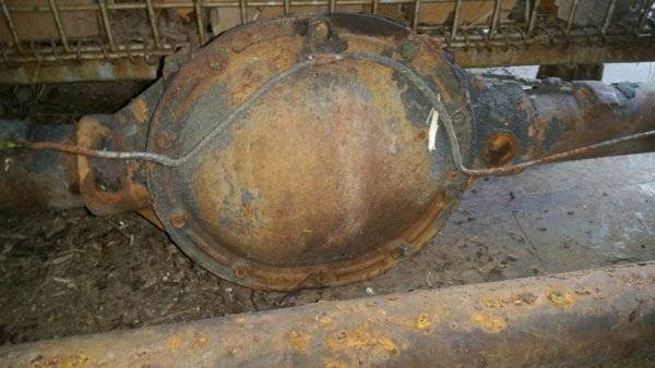

So I have what I'm fairly certain is an 8 1/4 rear end stored away that come out of a b body. Should it be fine paired with a mild 440 or bite the bullet at upgrade to a 8 3/4? Thanks,
If your gonna have any power out of the 440, I’d get the 8 3/4.
