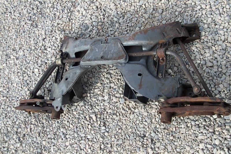

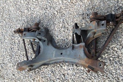

This is the correct K and sway bar for both of your 71 440HP's. 440HP's had the skid plate. 383 car won't.
The sway bar in the ebay ad is either a 66-69B or 73-6A
Also that 6-pack K should have a skid plate.

sounds like someone used abody LCA's the sway bar mounts should be closer to the middle like in the pic, I don't think an abody k member fits a bbody but don't quote me on that!
