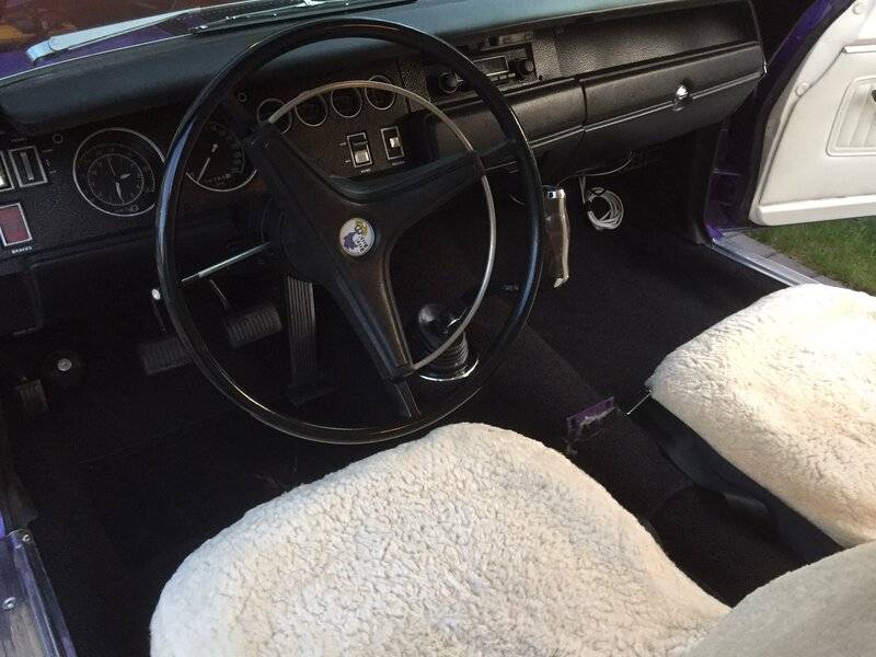

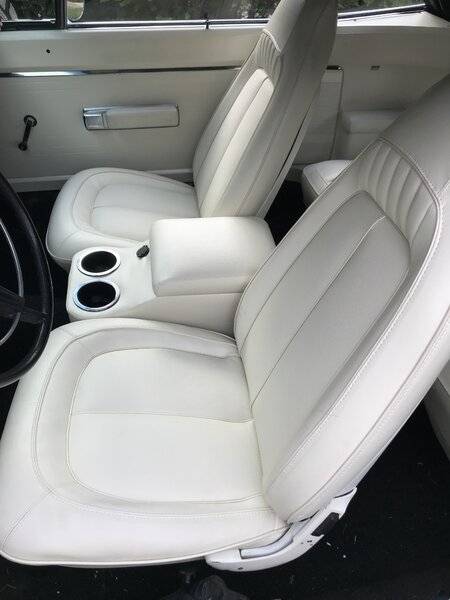

If you go to an automatic floor shift, you will have to install a console. Consoles in nice condition are big bucks. When I converted my RR, I sold the console for $600 and it wasn't perfect. If you stick to the column shift you can also install a buddy seat which gives you an extra seat up front but also folds down into an armrest when not used as a seat. The buddy seat brackets have to be welded in though. Or, you can buy an aftermarket console/armrest which just sits in between the bucket seats. I did that and it was great. Had cupholders and also a USB port to charge my phone. Here's some pics. First 2 are the Satellite with the Humphugger console.
Above pic shows the buddy seat bracket sticking up through the carpet between the two seats. This was after my conversion to a 4 speed. Plus the pistol grip shifter is just BAD *** !!!
