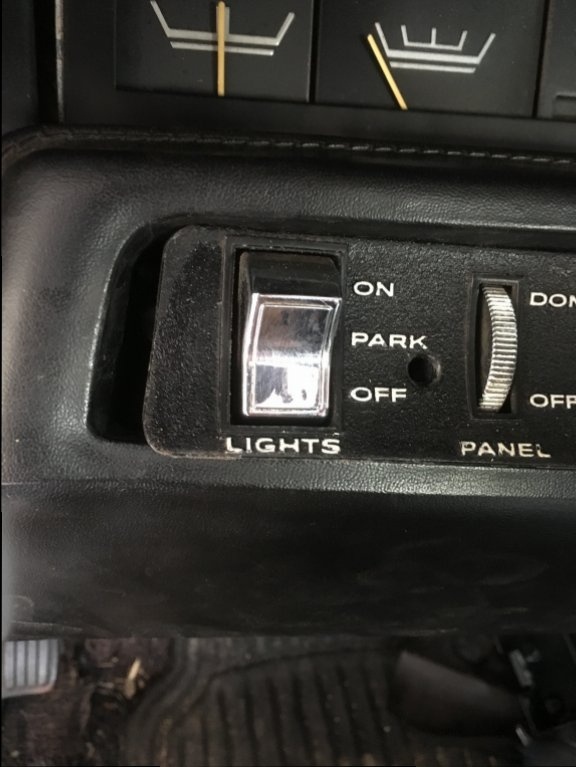

So I finally found the dang screw in the top left side on the panel but it still isn't coming out... :BangHead: I assumed it would come out enough now to unhook everything?
Nevermind it I got it. One of the wires were snagged and wouldn't let it come out.
You'll need to unplug the harness wires first. There's not usually enough slack to pull the switch panel out with the wires attached.
I just did this two weeks ago. The lower dash pad shrinks and hugs the panel. I had it all disconnected with the dash also out of the car. It was the hardest part of dismantling the entire dash.
Thanks once I unplugged everything and prided the pad open enough I was able to wiggle it out. What a PITA I attempted doing this 2 years ago and gave up once I saw where the nuts were I had to get too. This time around I was determined and had already removed some of the stuff in the way.
