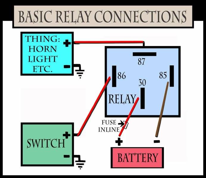

Could add a relay, to the brown/blue wire, to trigger the pink?
Please let me know if I’m wrong.
30 12v
85 ground
86 brown/blue?
87 pink?
Would it eliminate the interference?
Would I need to shield the wire going to the Blue/Brown to the relay?
