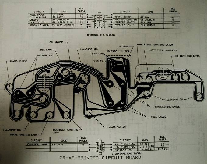

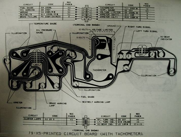

Having the circuit board would be smart, the non-tach dash is a bit different.
With out Tachometer:
With Tachometer:

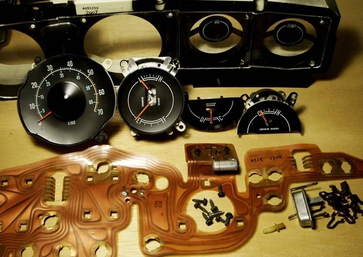

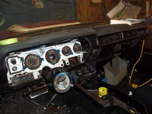

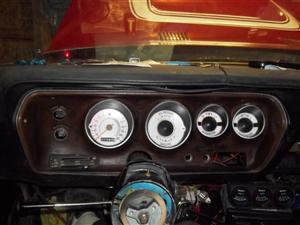

Some good information diagrams and info MAGNUM! Dobaroy, If your going to do this and have things torn down, I have a site that may have the white overlay gauge fronts if you would like white, instead of the black faces, prices are more then great and easy to do if its torn apart as MAGNUM's picture there is showing, just let me know and ill dig it up and post it for you. picture of my cluster with them on it.. before/after.. only a suggestion.. Good luck in this..

Look closer, actually the wiring/plug is the same. Pin one on the bigger plug is not used
for the non-tach dash. Everything else is the same, the gauges are the only thing moved.
All you need to do is add the one wire for the tachometer.
Here is everything needed to do the change over. Don't forget the lens pod, it
is different too.
