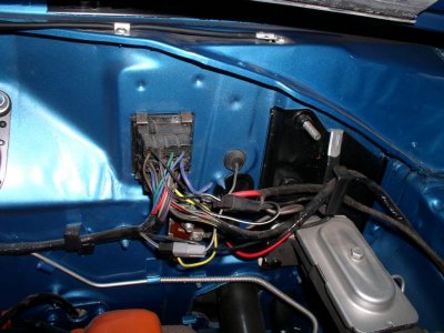

Through firewall like H2E said. just above the starter solenoid attaching bolts, here is a pic of mine, it's a 70 GTX but I think it's the same.
MINE IS WRONG, the pics below are correct.

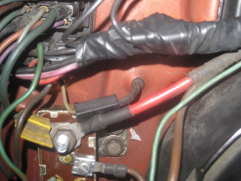

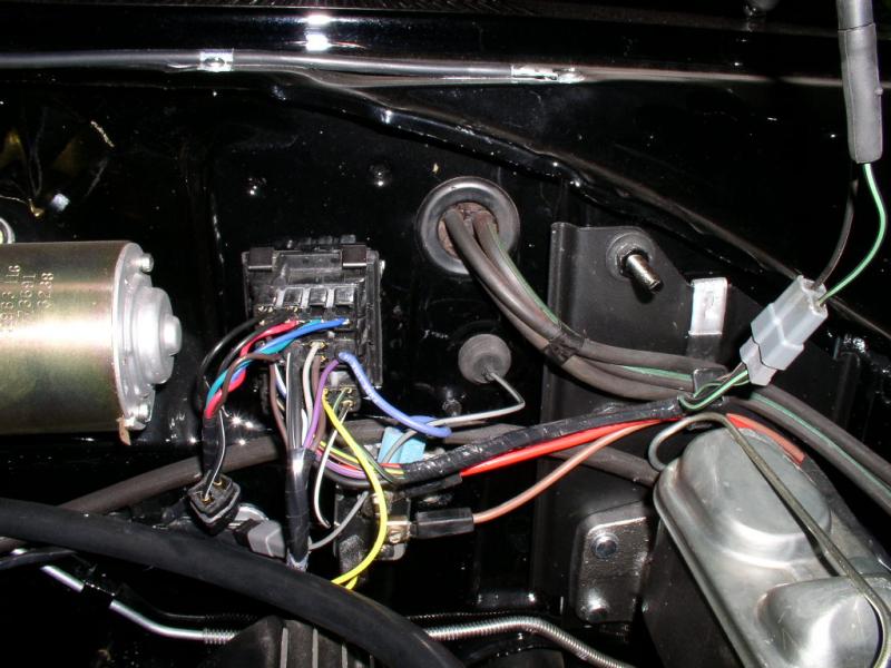

Here is a shot on my 69 Charger & 69 Road Runner. They are both factory tach cars. It is the grey wire with a black tracer between the bulkhead conn. and the master cylinder. This should be the same as yours.
