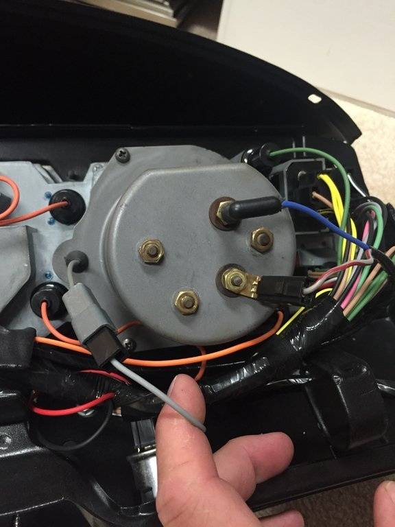

I have a repop tach in my 68 runner. We're replacing the entire dash harness, and need to know what the two wires are, on the back of the tach. There's a spade terminal, and a post. Which goes to where???

spade terminal goes to the tach, post is for power

Per '68 fsm the dark blue is key on/acc power from 3rd fuse w/turns,rear defog,htr.
