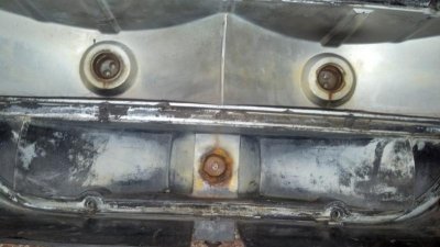

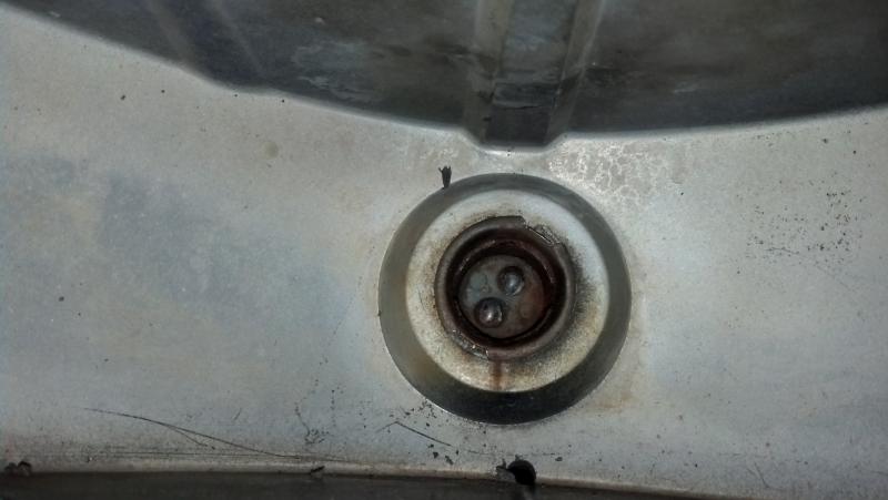

Here are pictures of my bezels, The sockets are crimped on- I can spin them with some effort so no glue. IMG_20141026_221929_585.jpgIMG_20141026_221908_388.jpg
they are installed by pressure. Replacements available will need to be installed with glue. Will require some trimming on housing
Thanks for the pics. Now I know someone glued in some sockets. I am going to replace them all while I have everything apart. Found some at O'reilly's that will work.
when I said installed by pressure wanted to mean they are machined installed with a press, making a sandwich with housing. Not really serviceable easilly.
