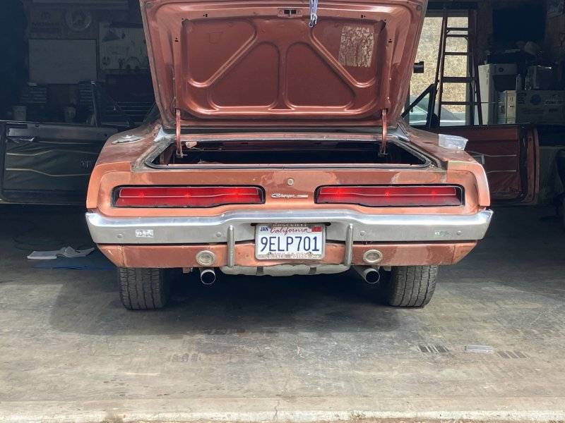

@1 Wild R/T is a guy that has mentioned how dim he noticed classic car taillights to be and it got my attention. I have made efforts to make my taillights and brake lights brighter by painting the inside of the housings with white paint.
Stock:
After painting the insides of the housings with white house paint:
This might help you in the future.

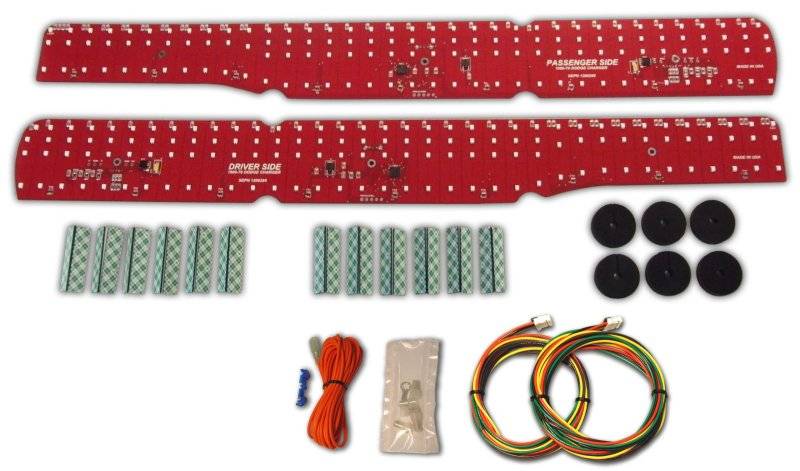

Do NOT put LED "conversion bulbs" in an old school light assembly.
When you have a bulb, the light exits the bulb in a 360 degree field, and it bounces off the reflector in the light assembly. What you see from outside isn't the 3/4" light bulb...but the reflection of that bulb in the 20 square inches of reflector surface.
LEDs are directional - they send light in ONE direction, usually out the top of the bulb, directly at the red lens (ignoring the reflector completely). That gives you a 3/4" hot spot...and a dark lens and reflector.
If you look at effective LED conversions, it isn't just a bulb. It's a whole assembly, designed around the directional output of an LED chip.
69/70 charger led conversion kit:
See how many LEDs are in there? It's a hell of a lot more than six...like the stock

I like the idea about improving the reflectivity of the reflectors to make it brighter. But i detect a bit of photo trickery in your photos. The top pic in in bright sunlight with the car casting a shadow on the concrete. And the bottom pic is not . Making the bottom pic taillights looking brighter in the dark. Just my observation from a guy thats practically blind in my left eye.
On the reflector refinishing...movie screens are a reflective white. White, but with some reflective/pearl bits in them, to aid the off-axis viewing. They make a "reflective" spray paint - no color, just the pearls. I've used it on driveway boulders - daylight, invisible. Headlight beams at night, they pop. Nice and bright.
Tony Tee......
"I like the idea about improving the reflectivity of the reflectors to make it brighter. But i detect a bit of photo trickery in your photos. The top pic in in bright sunlight with the car casting a shadow on the concrete. And the bottom pic is not . Making the bottom pic taillights looking brighter in the dark. Just my observation from a guy thats practically blind in my left eye."
I had to copy and paste this to get it to show up.
There was no intentional deception. The pictures were taken on the same day from the same distance from the car. What I couldn't control were whatever clouds were in the sky and the position of the sun as it shone through the tree branches.
