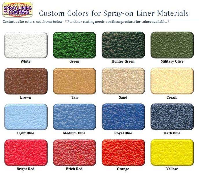

You could get the plywood I posted above and coat it with bedliner. buy some pin striping tape and copy the lines onto the board then bedliner it and peel off the pattern. The pattern would be the low point and the bedliner would be the high point.
They now tint bedliner...
