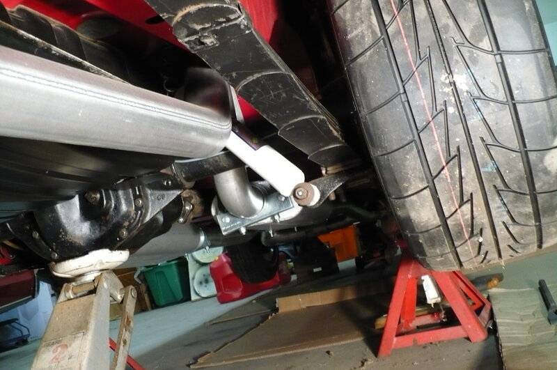

Coil overs look almost vertical. Right where tailpipes go. My 65 Dodge with TTI 3" tail pipes.
