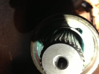

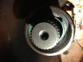

Hello!
Can someone tell me if this is right?
I remover the seal in the end of the trans and there is a small hole
That is normal, and causes no issues. You can use the hole to deform the bushing, facilitating replacement without taking the housing off.
line the hole in the bushing with the galley in the tailshaft this allows lubrication of
the yoke. use a bushing puller to remove the old bushing and the install tool to
install. I have both tools if you want to see a pic
Thanks guys! so no need to worry then!
Actually i´ll just be replacing the oil seal.
