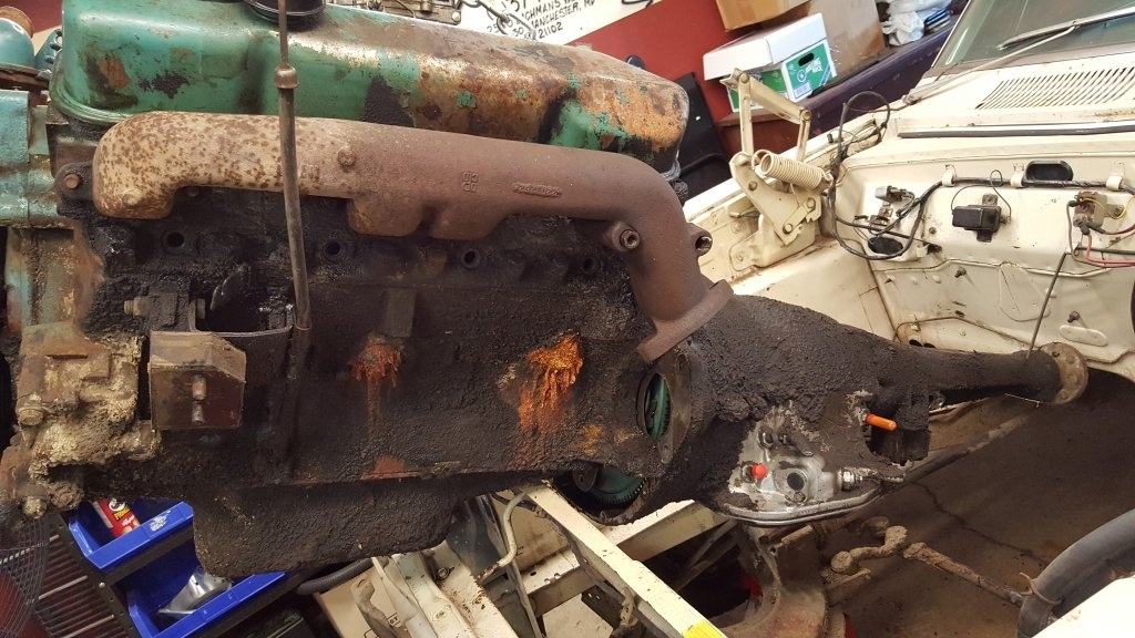

Finally after all this time, I'm at the point where I can make some headway on this car. Finished the engine build last week so that gave me the green light to yank out the original 361hp. I'm not going to disassemble anything until I have the replacement parts ready. If this was a rotisserie build, it might go a little different.
I decided to pull the engine and trans together. Man that's a tight fit and I won't be installing the new engine the same way. (Looks like I'm in the market for a trans stand/jack of somekind). I had to stop halfway, set the oil pan on the K frame and readjust the chains. Then the oil filter had to come off. Then the water pump was interfering with the hoist so I took it off, and that just made it. I've pulled the engine and trans together before but normally we were junking the car. I thought I was in trouble once or twice but we got her out.

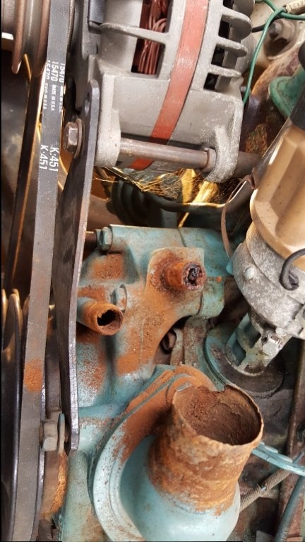

Rust! The radiator weights a ton!

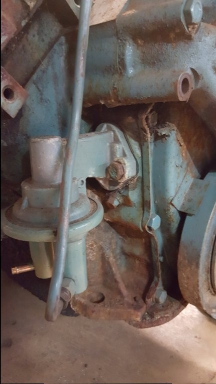

Original fuel pump? Check out the push rod plug!

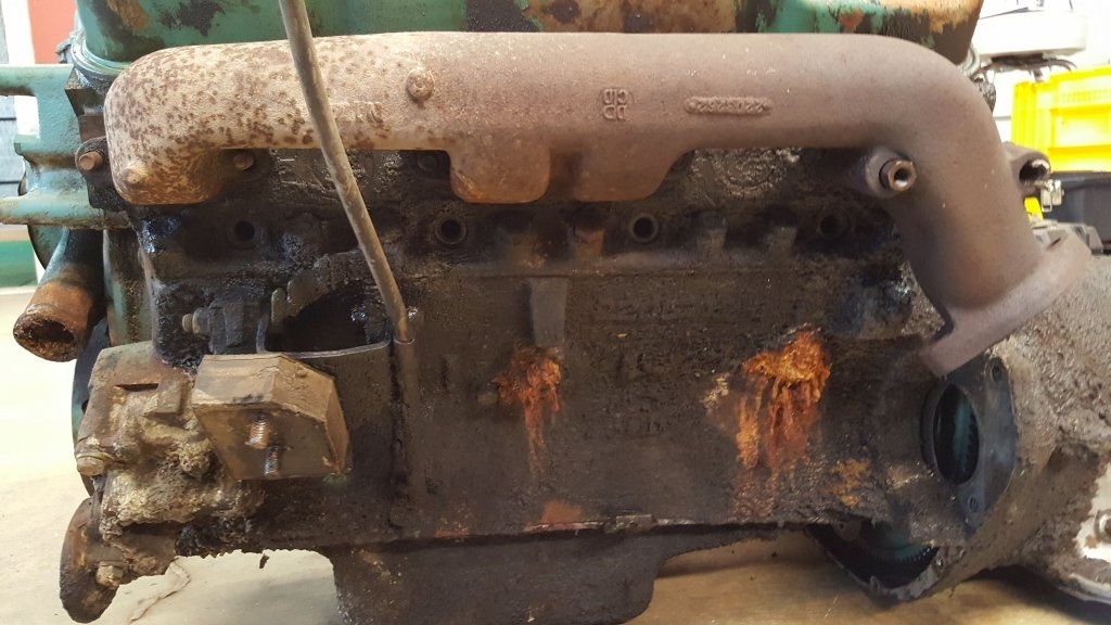

Over due for a valve cover gasket?
And frost plugs?

The very first engine I bought was a 361....passed on as a 383. Got burnt so I learnt....how to ID them early on! And for years I pulled engine and trans together but used two points with the chain and learned exactly where to put the hook for the right positioning. Finally bought an equalizer and never looked back. Pretty small apartment there....:D

I recently pulled my dads 318 apart and could not believe the thing could still hold water, rust holes threw most of them being sealed by more rust!

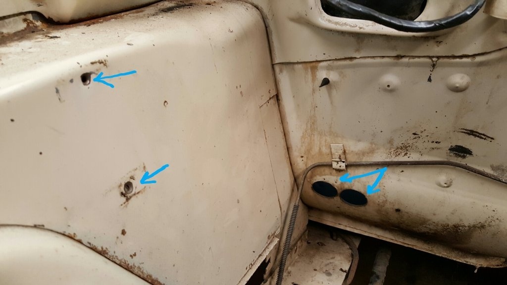

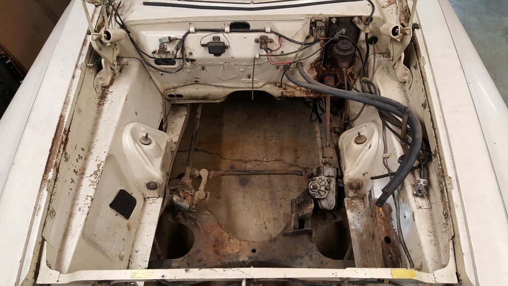

There is a mystery about some holes found in the engine compartment. Looks like there was an aftermarket a/c unit at one time but there is no sign of a compressor being on the engine (has a single crank shaft pully) or condenser ect. There are two sheet metal holes under the dash and a blue and black wire that had connectors on them at one time. I'm going to weld up the two holes in the firewall but was curious about the two sheet metal screw holes on the right fender. Looks like a line bracket was there. Also does anyone know about the hole on each side of the tunnel? Any thoughts?
Yeah, Looks like add on air at one time. The holes in the floor are for the Box type evaporator.Maybe mounting holes and or drain holes.I call them knee knockers.Just did a 68 Valiant that had dealer installed Mopar A/C.same two holes in the floor for drains and the evap box was mounted to the dash lip with a few screws.
