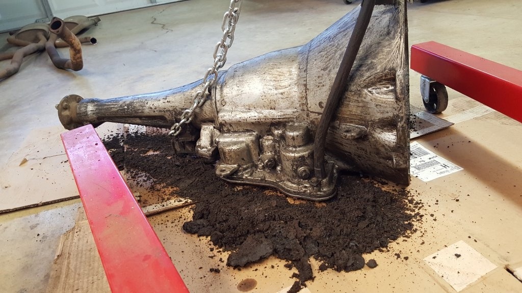

What do you know, I found a transmission!
It's amazing to me things last as long as they have. The freeze plugs for one, but they could have been replaced at some point. The fuel pump on the other hand does seem to be original. How the heck does it last that long? No wonder Chrysler almost went tits up in the late 70's.

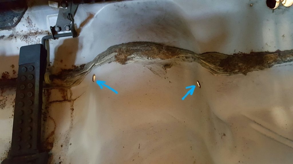

Gonna be a great car. Just curious if this had a center console? Maybe the two holes on the top/sides of the tranny hump had the cables running through or mounting hardware? Just a thought.

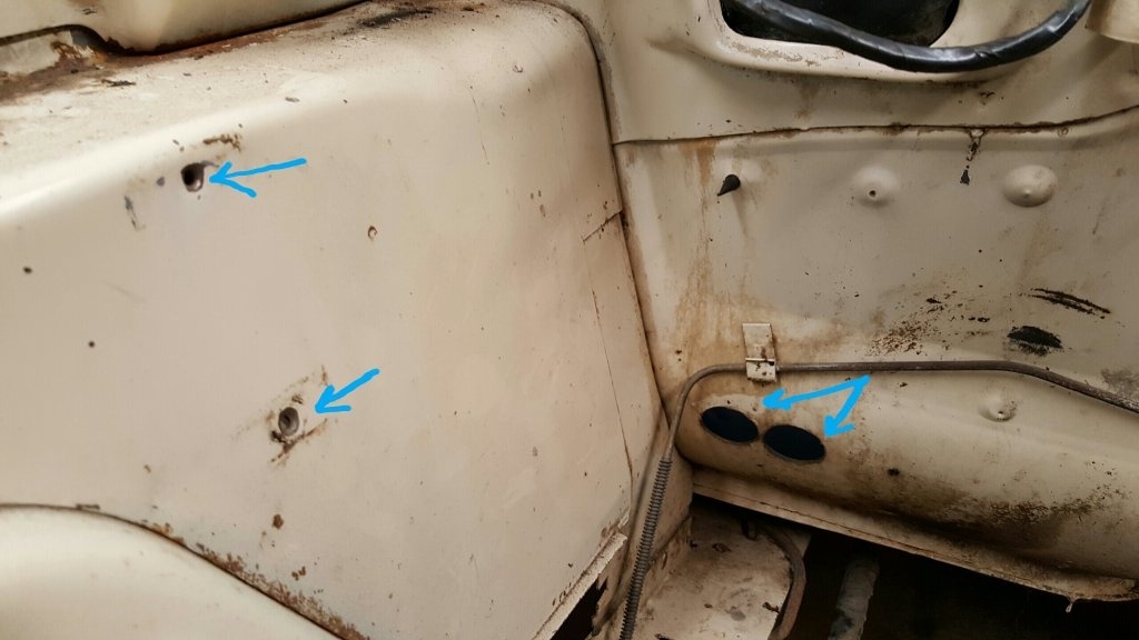

There is a mystery about some holes found in the engine compartment. Looks like there was an aftermarket a/c unit at one time but there is no sign of a compressor being on the engine (has a single crank shaft pully) or condenser ect. There are two sheet metal holes under the dash and a blue and black wire that had connectors on them at one time. I'm going to weld up the two holes in the firewall but was curious about the two sheet metal screw holes on the right fender. Looks like a line bracket was there. Also does anyone know about the hole on each side of the tunnel? Any thoughts?

Also if iirc, someone else had posted an inquiry of the same type of holes in the fenderwell apron. I dont remember if they ever received an answer though, maybe a year ago...????....

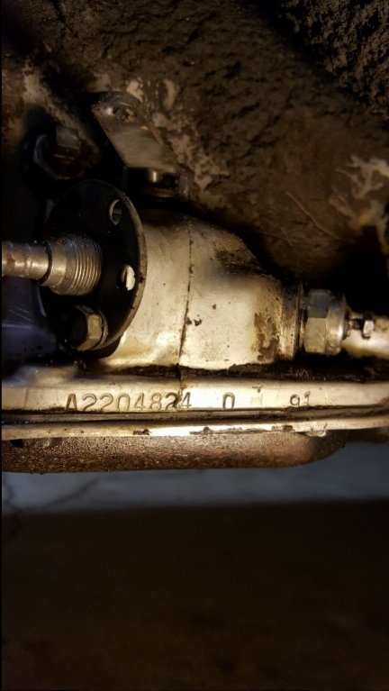

About that trans. what year is it? Cant see in the pics to well,where is the adjusting wheel for the cable shift? Just curious....
It's a 1962

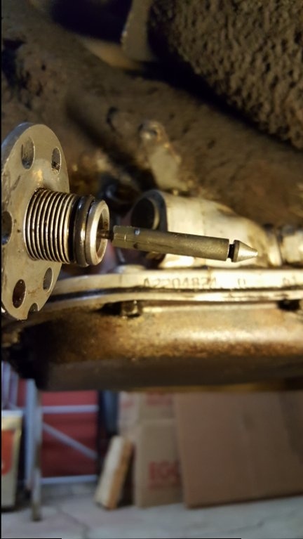

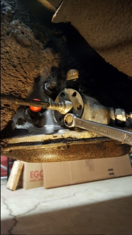

I removed the adjustment wheel with the cable

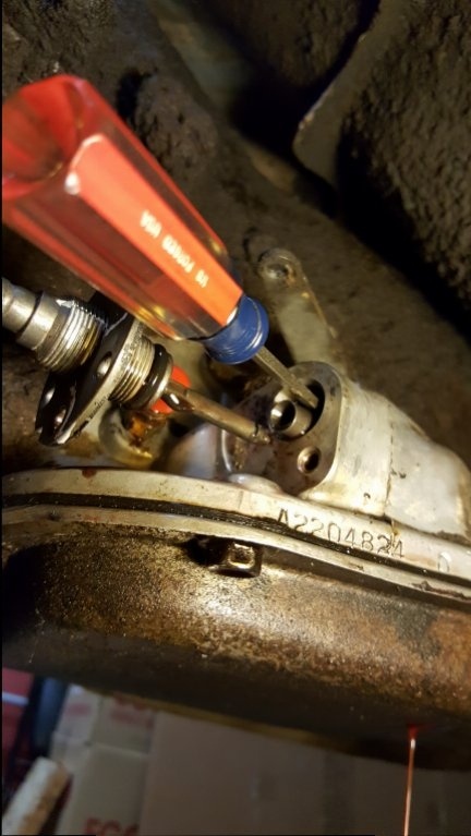

There is a spring inside holding the end of the cable
Place the shifter in reverse, thats the longest throw of the cable. Useing a small screwdriver, push the spring to the right. That will release the cable end.
