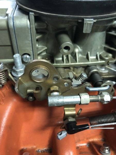

Thanks! I’ve decided also to measure and see if I can switch holes in the carb linkage... there’s one hole for the ball-pin that is closer to the throttle shaft, which should mean it requires less travel of the pedal to effect full rotation of the linkage... we’ll see if it is workable. I’ll almost certainly have to trim down the cable to use that one, so I wanna be sure I can before I make it permanent.
The hole in the red circle is the one I’m aiming for.
That is a very reasonable approach. The carburetor "throw" will be less, but the cable "might" have to be anchored lower so it can "pull downward" near full open throttle...maybe, so check... and re-read coloradodave's post & check the Lokar instructions in my opinion too. You will get there.
So I switched the cable pin to the more centric hole... I had to drill it out a hair to fit the pin, but it went well. The cable alignment was good, cable pull is straight (straighter than the original hole, actually) and shorter. The difference between throws at the carb is about a 1/2” of cable, which is enough that now my pedal can go full closed to full open, instead of closed to 80%.

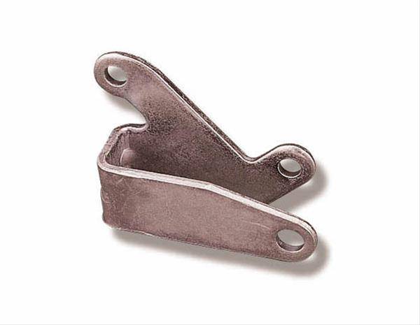

I dont see the "Chrysler adapter" on the carb. Holley part #20-7 throttle lever adapter.
It is a must have to correct the geometry.

I replaced the 750dp with a new 770 Street Avenger. I used holley 20-2 kit to relocate the stud as shown in the picture. Relaced the cable bracket with an updated Lokar one, adjusted all the cables, and tune idle mix... and now she’s fun. I get full range of throttle, good kickdown performance, and wayyyyyy more power with the properly-functioning carb. All winning!
I may re-jet some, but I’ll have to watch the plugs a while first and see how she’s burning. But this was the alarm clocl kit she needed to wake up.
