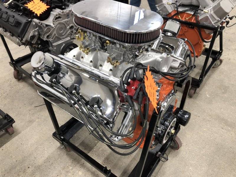

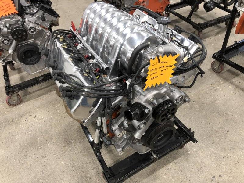

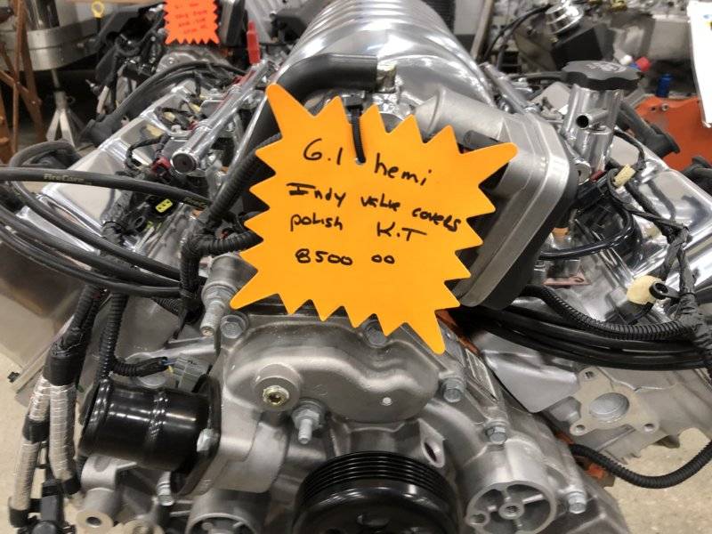

I went to Indy this year. Our booth was in the same pavilion as Indy. They had a 6.1 all dolled up with the coil packs hidden. Pretty sexy!
04723CFD-5F02-4B5A-A96E-00B8CFBCC966.jpeg 7C34569F-2112-4FE9-B7F9-85EB25B7431B.jpeg 8D0099D9-589F-48CA-A5FF-B6D3FDD7E511.jpeg
