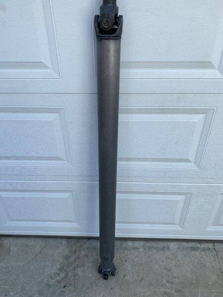

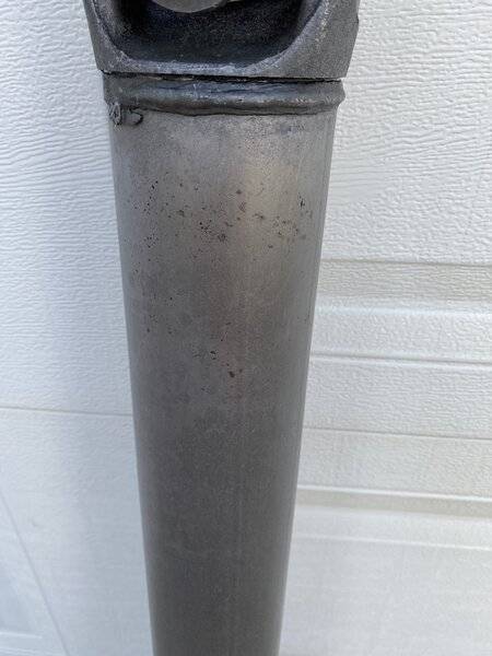

Here is my driveshaft after soaking in a 4” pvc tube. Cleaned first with oven cleaner and then evaporust removed 50 years of rust. The stuff works pretty good.
