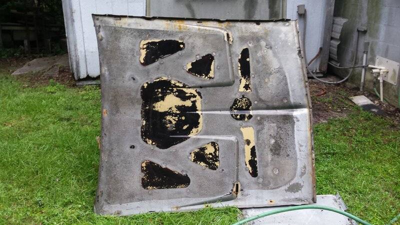

Yes, the molasses mixture works great if you plan ahead and have the time. And evapo-rust is available at harbor freight.
I separated the substructure from my hood and soaked it in the molasses mixture for about 2 weeks and here's the result. All the surface rust is gone . Leaving only the paint.
