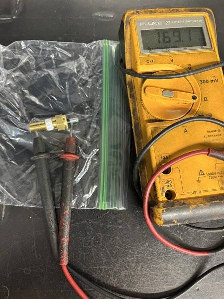

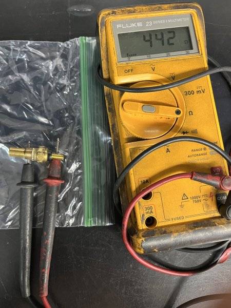

During my engine compartment refurb I had 2 Standard Motor Products temp senders that would barely register on the factory gauge, both were out of factory spec. I listened to Wayne's advice and sought out an NOS sender.
When these photos were taken the ambient temp was somewhere in the mid-80's F.
Aftermarket sender
NOS sender

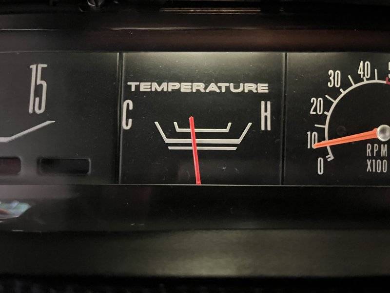

Gauge with NOS sender and verified 180-185F with an infrared thermometer.
Yes your bottom photo is where my stock gauge sits when the Auto Meter is at the T-Stat's 180 degrees. Your SMP sender was likely for some other vehicle.
