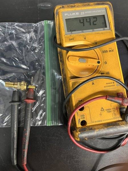

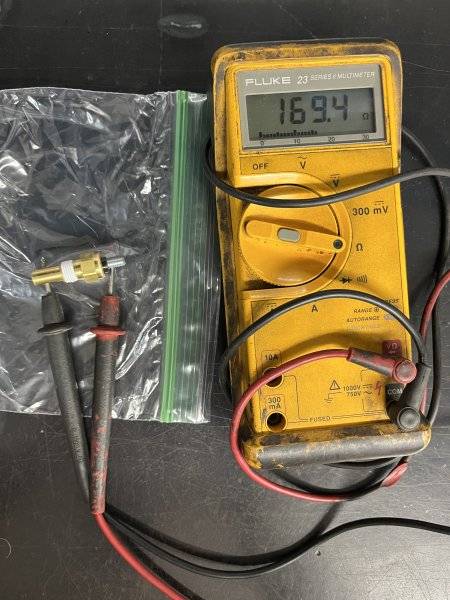

TS-4 looks the same as a Mopar sender but there’s no Mopars using that part number listed in the application guide on Standards website. I believe it should be a TS205, in which case don’t bother. I tried 2 of them in my 69 and both barely registered on the gauge. The ohms were way off compared to a NOS one which actually worked.
Correct sender reads around 360 ohms at a shop temperature of 68/70*F. Check any of them before install and better yet, post a WTBuy for an original OE sender.
IIRC you were the one who steered me in the right direction when I was having issues. Good information, thanks Wayne…
TS205
NOS (ambient temp was higher than 68/70 F)
