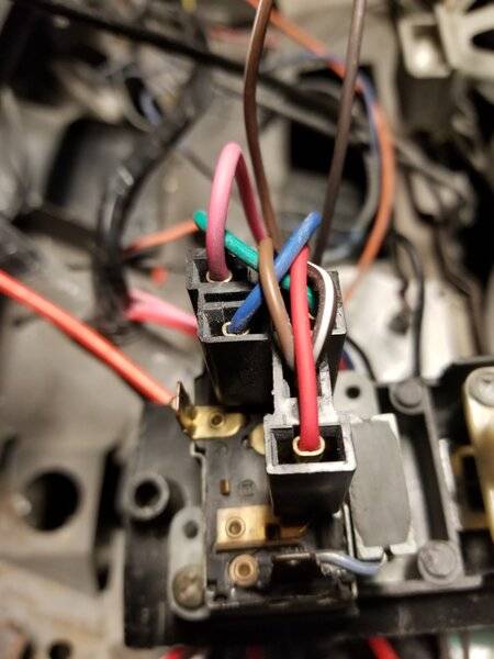

This is what I have for wiring. On the right is two wires, in the middle is a 5 prong wire, ont he left two more wires. My switch has seven spades, wire only has 5 plugs.

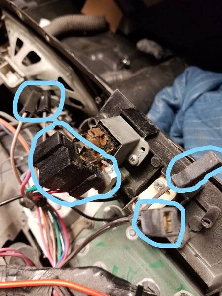

Here is my wiper switch plug with the empty spades on the left and bottom. What goes there?

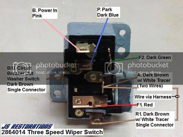

those are for the wiper pump brown and brown with white traces,thats why I posted the thread.
Thanks Davek, The thread you posted did help. I have one brown with a white tracer and three browns? Which one of the three browns goes on the left? Do the other two browns go to the washer button? I wonder, if the brown wire isn't plugged in that's what causing the shocking?
yes 2 browns to pump switch and the brown w tracer should have a brown wire next to it on the harness.
Thanks Davek! I'll give it a try, appreciate it!
Well it worked the way its supposed to! I got all three speeds but I had to ground the switch panel to the frame, which I think will be grounded when its installed. Before I couldn't get 3 speeds. When its not grounded the speeds go haywire. Thanks again Davek, you solved a problem I have been having for a while!
