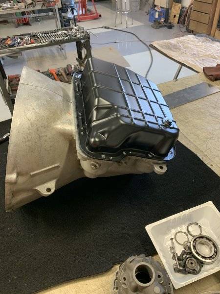

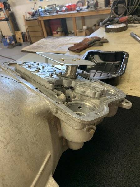

Fabbed up a drop tube for the filter, there was a gasket in the kit for a filter so I used it . The deep pan is the one Doug has posted on here that can be found on Amazon for 30 bucks- it is 3” deep. Nice pan with a drain plug. The extension puts the filter 3/4” above the bottom of the pan.
