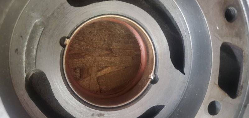

One tip i found in several Youtube video's was that if you can find one, change the rear clutch Bellville spring for the later model ('74-up), which is more beefier/stronger. (mine shown in the picture, the "skinny" version)
You can't just change the spring, IIRC. You need the piston as well....and maybe more. I gotta look at some parts lol... Someone that does these more often will chime in.
As far as I know the late spring works on each piston. But the early spring works just fine.
From what I've seen is they pulled a 727 apart with an early spring and replaced it with a later spring together with the metal version of the washer/ring that sits next to it.
The original was a plastic one, they recommended to use the metal one for racing an diesel applications.
I will stick with the original one then I guess.
Regarding the front drum bushing, I think it is a typo as I did not find any info on this small size difference on the stator support.
If I purchase that pump (complete) I can always reuse my own stator support as it is in good condition.
Still looking for the pieces to compare..... did find where Carl Monroe`s book says "the springs do not interchange "....maybe I'm missing something??
I've never had the plastic spacer break. Melt? yes during a catastrophic clutch failure. I have seen the weld on the metal spacer break. The rear clutch piston and spring are changed as a pair. The pistons and springs are different heights. The rear clutch always applies when the vehicle is stationary. High line pressure and a blocked accumulator can contribute to failure. Though I've never failed either type. The rear stator bushings from 67 and up are all the same. Trans Parts on Line sells Rabestos, Borg Warner, Alto.
