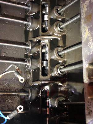

I pulled the left valve cover and rocker shafts.....
So far, nothing. The lifters all looked great and all spun easily in the bores.
Next up, the 2-4-6-8 side. The lobes that I can see look great though.
I have wondered if the shavings could just be piston ring or cylinder wall from normal wear, distributor drive gear to camshaft wear, timing chain and sprocket wear or a little of each.
Again, the oil pressure is great. The engine runs the same. There are no knocks or rattles that I have noticed. If I find nothing when I pull the RH rocker arms, I'm going to screw it all back together and just run it.

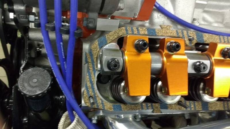

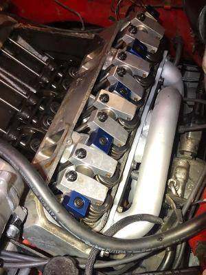

That's exactly what I saw. Are the rocker spacers rubbing? Are they roller bearing or bushed? That would be the first place I'd look.
I looked at the wheels. The rockers all move freely with no slop. The oil collected in the LH head looked fine. I swiped it and smeared it and it looked fine with no pasty substance. The rockers are bushed, no bearings. They were from Mancini Racing and billed as a Harland Sharp product though they came in an unmarked box with absolutely no instructions on how to wet them up and assemble them.

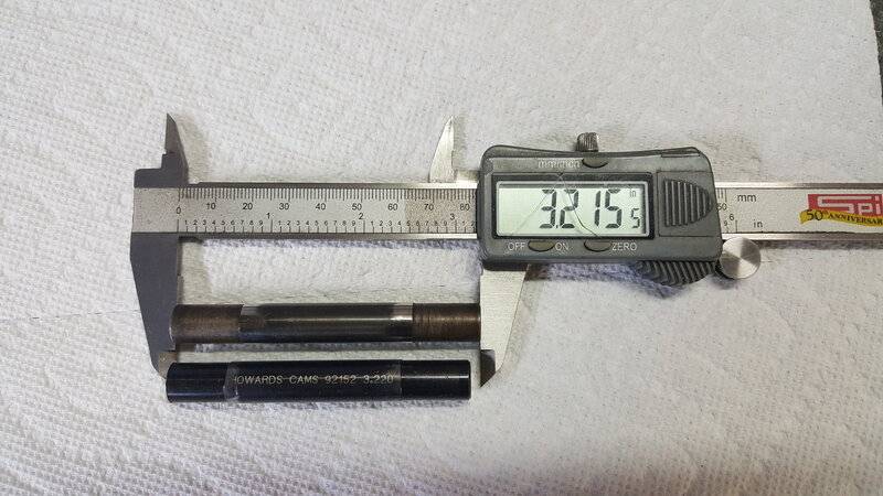

You mentioned the fuel pump push rod. If it's an aftermarket one it's worth checking. I had installed the Howards and I'm glad I checked it. I found a used factory one (not the one in the picture) that still measured 3.220 and replaced.
